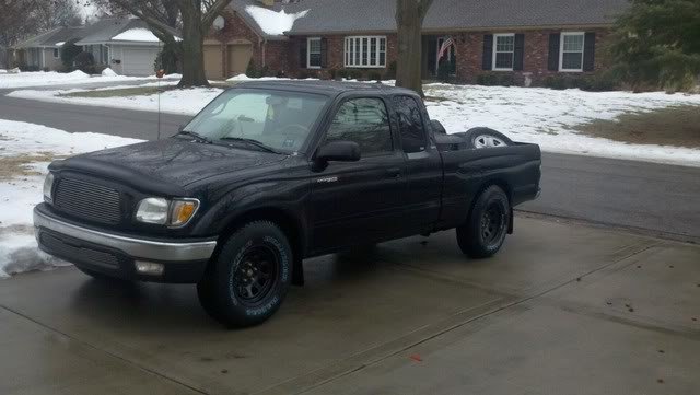

    Yeah thats exactly what I want, well for now. Untill income tax returns at least

    How did these rims finally fit on your Tacoma? Someone here told me that the D windows and the soft 8's run into the calipers. I was really hopping to get the soft 8 in 16x8, but now with that news I'm back at square one.

    I am currently running a 235/75/R15. No rubbing in corners but they hit the inner fenders on large bumps. I am gonna be lifting it 3" this week to correct this.

    http://www.4wheelparts.com/Wheels/R...=209&t_pt=100021&t_pl=101829&t_pn=PCW52-5865F
    are those the rims you have?
    im liking the look on your truck and now that im getting my taxes back im looking to spend some money
