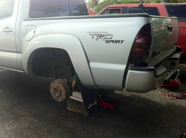

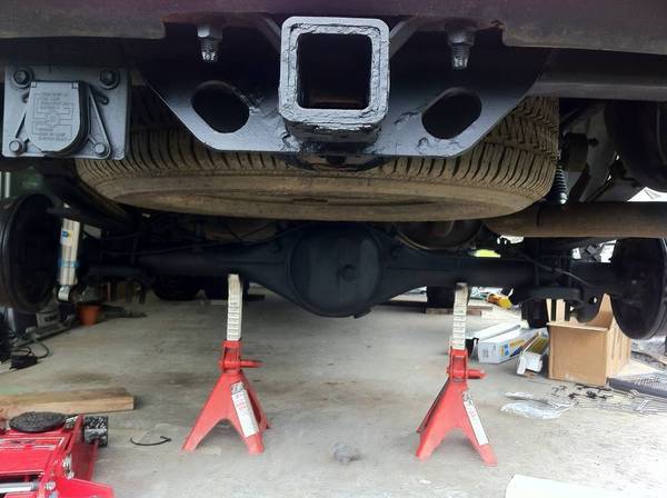

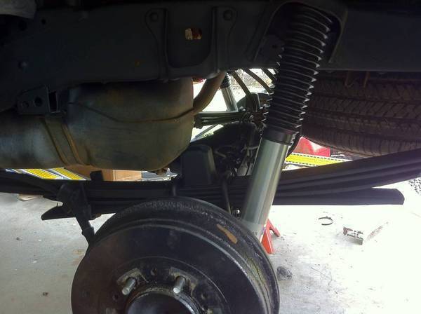

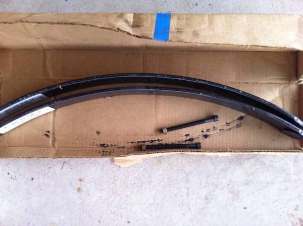

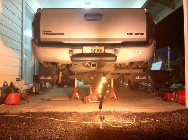

    7/18/12
    Tinted the tails and switching out to LEDs
    Picked up a 2" Toytec AAL
    7/19/12 - 7/20/12
    Ran into a problem with taking out the center pin. It would spin, and couldn't take out so I just used a grinder. Then the Revtek Ubolts were too long, so I had to add some washers. But Finally finished today, ill get some pics tomorrow. Sits a little A$$ high but hey better than blocks.

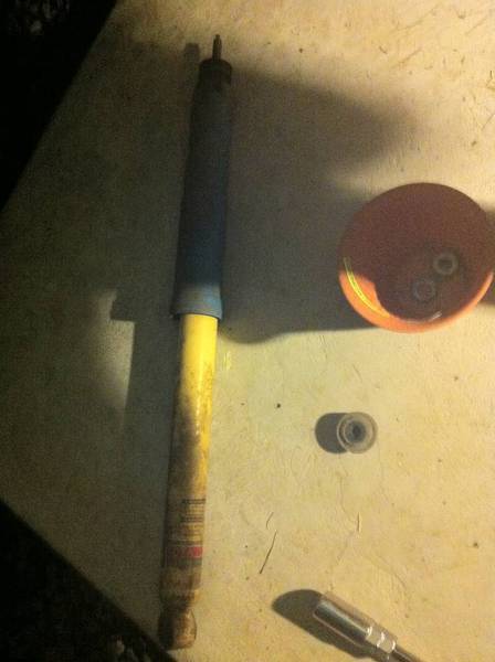

    Finally got my 5100s in the mail
    Set them to 2.5" and going on with stock coils.
    Started installing kinda late..:eek:
    Took a while to get these buggahs off, couldn't get a grip on the top:eek:
