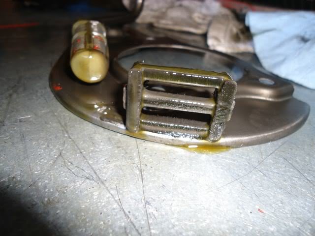

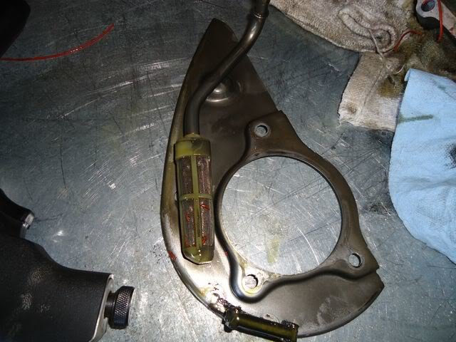

    The transfer case drain plug had no magnet, which surprised me... I assume there's no need for one?
