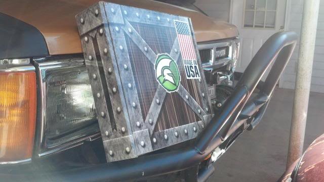

    On the other hand, this thingy showed up today.

    I'm gonna drop the Spartan in today :goingcrazy:
    She is starting to live up to her name, Gold Digger.
    Just priced out the final parts for getting duals set up and it going to be around $1300. Not to mention getting my driveshafts modified. Why did I pick such an expensive hobby?
    That price includes a Marlin adapter and Marlin 4.7 gears.
