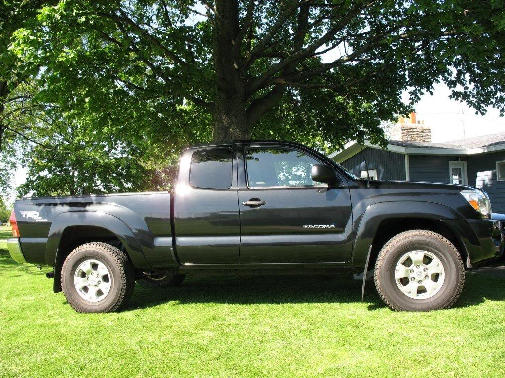

    ummm yeah
    .85 is bigtime noticeable.....i have an access trd or no tsb BEFORE

    CRF69 - Your truck looks really good. Maybe its just me but yours looks like its at 1.75 comparing to what mine looks like at .85.

    mine is second notch up from the bottom.....

    4 notch 5100's

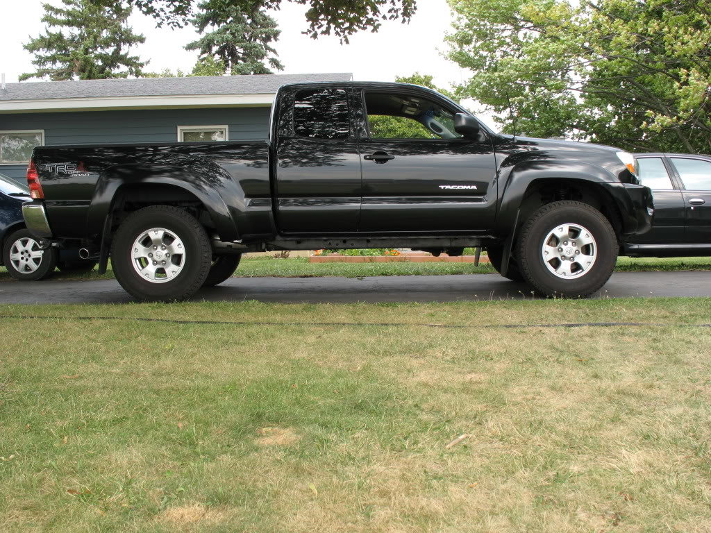

    .85 was noticeable on mine as well.
    Before: [​IMG]
    After: [​IMG]
    My friends couldn't really notice, but seeing the truck every day, I could notice more difference than expected. I will be bumping them up to 1.75" in the next couple weeks, and adding 1" to the rear (If it needs it) to keep a factoryish rake. I don't want a nose high truck, and I'm worried about snow/ice in the bed giving me a nose high look all winter.

    Those .85's look great, nice and level. I know the 1.75 will leave me nose high, especially once I put sand bags in there. To give the rear another inch (if I did 1.75) I'd then need a block or another leaf? Already have TSB done.
