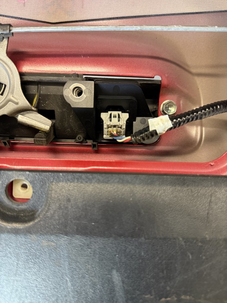

    I have a Joying head unit and the OEM camera (6 pin) works with it. Looking for better resolution, I recently replaced the backup camera with an aftermarket Levanlight which is listed as 12V (I am sending is back as the view is not as wide as the OEM and feels less safe). The Evan Fisher camera linked above appears to be out of stock on Amazon. Is there no way to mod a 12v RCA camera to 6-pin to work with the factory harness?

    Modding the electronics in a 12V camera to make it 6V is unrealistic and out of the realm of DIY. You would need to mod the wiring to feed the camera 12V which is in the realm of DIY.

    Isn’t my setup all just 12v?

    1. So what I understand here is that the power output from your Joying is sending 6v output to a stock camera.
    2. You would like to install a 12v camera with better resolution but need a way to power it with 12v triggered to come on in reverse.
    3. Just want to clear up 6 pins and 6 volts in this thread.

    What I understand is (and I’m no expert) that the power to the camera is actually pulled from the reverse light harness and it’s 12V (i.e., is independent of the head unit) in (all? some?) of the Gen 2.5s (mine is a 2014 TRD). Also understand that 6-pin = 12V and 4-pin = 6V. I don’t have a voltmeter so can’t be sure of any of this but since the Levanlight camera worked (stated as 12V), I figured I have 12V in the camera harness. IF all of this is correct, my question is whether it’s possible to mod the RCA output from an AHD camera (of which there are many, including one from Joying I’m using as a front-facing camera attached to the same head unit) to fit the 6-pin harness in my truck. I searched for an RCA to 6-pin adapter and didn’t find one. It’s also possible that the factory harness is incapable of carrying a 1080p signal. Dunno. Thanks.

    Well, my 2015 original head unit to the 4 pin camera actually supplies 6v output to the camera via the harness.
    Typically aftermarket cameras instruct you to tie into the reverse light to trigger the camera and is independent of the head unit.
    I am not versed on a 6 pin camera setup but if you have a schematic I might be able to help. My understanding was that 6 pin was for the rear view mirror camera setup but that may be incorrect.
    It is possible to mod your harness to adapt to a RCA output.
    I just cut an old A/V cable and wired it into the harness to adapt it to my Pioneer HU when I changed over to it.
    Finding a break out harness for this may be impossible, I don’t remember if I looked and I am cheap when I can use what I have on hand and my skills.
    As far as the 1080p signal, the limits of the AHD analog signal over the additional footage of the wire harness should have minimal impact since AHD limits are 500 to 800 meters.

    That’s helpful. So, not all Gen 2.5s have 6-pin (12V). I’ll look for a schematic and post back if I have any luck. Tried searching on the web / Amazon for RCA to 6-pin adapter but unsuccessful so far. Thanks for the info.
