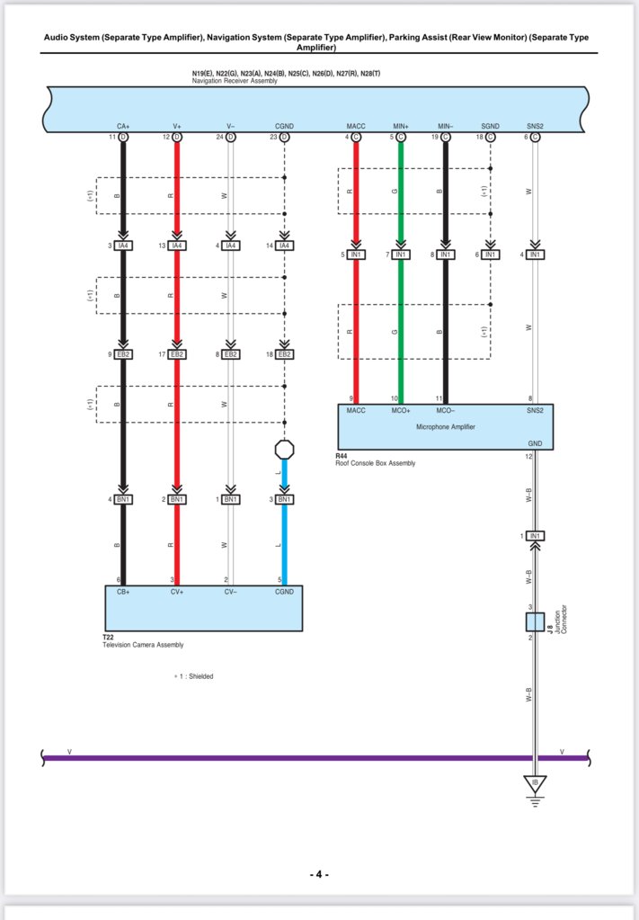

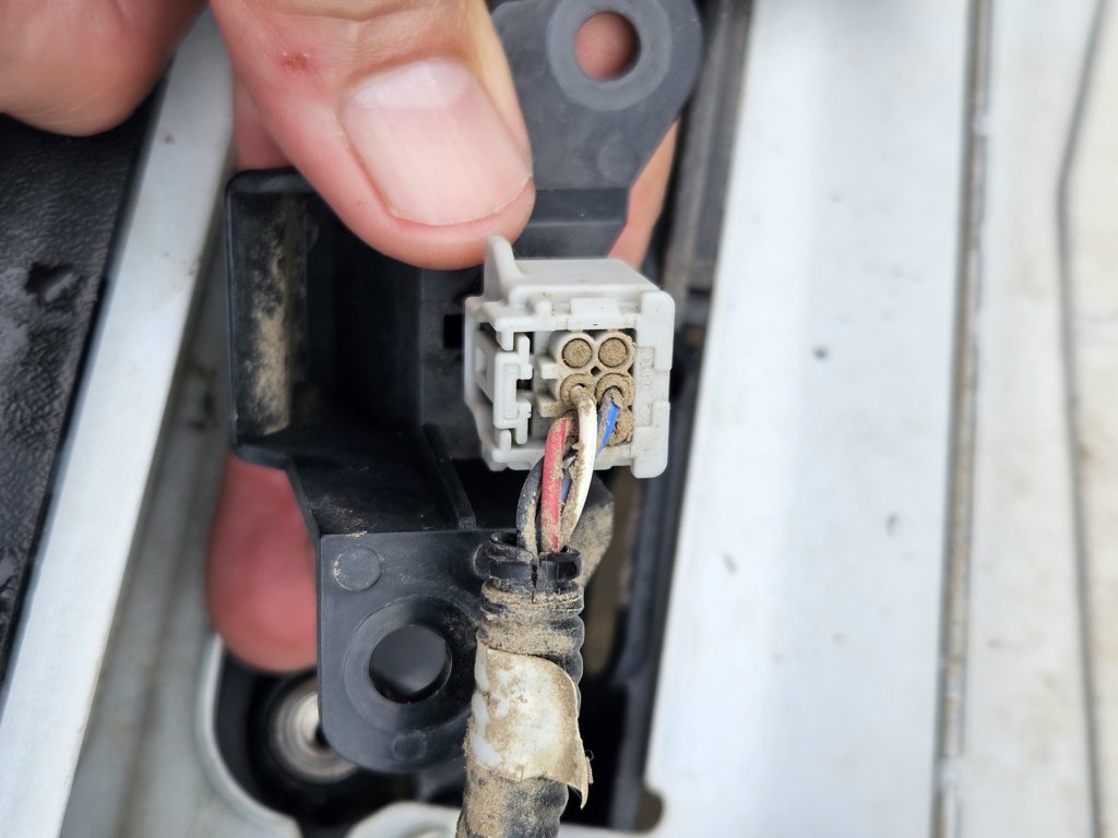

    Hey @secondgear sorry I just saw this. That’s kind of what I suspected a 6 pin plug with 4 wires and different people using different terminology. I only remembered the wires and not the connection. Are you still working on this? I attached what I found I used to pinout my system. Red is Video+ and White is Video- The crazy thing is Black is the power wire for the camera and the blue is ground. I’m not sure how the trigger works on a Toyota Head Unit but If I recall correctly the 6v is constantly powered to the camera from the head unit.
    I can’t verify this, I have since replaced my original with a Pioneer unit.
