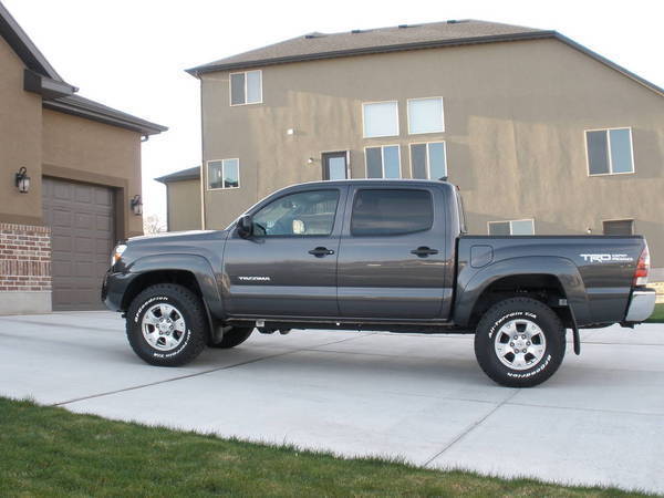

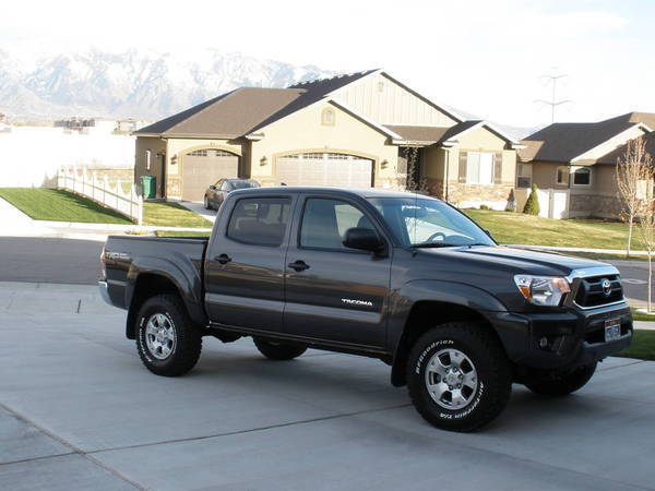

    Sorry it took me so long. I kept meaning to do it and everytime I thought about it my camera battery was not charged. I really like the ride of the new 883 springs with the Wheelers HD leaf pack. It did give me a lot more rake than I was expecting. But I still like the way it looks and when I load it down to go camping and such it will not sag. I also put new 265/75R16 Bfg allterrains on it as well.

    No worries, the pics were worth the wait! You truck looks fantastic man, good call on the setup :thumbsup:. I personally think it has the right amount of rake, and it will probably still settle a hair or two after a month of driving around. If it doesn't I did talk to Wheeler's and they said the OL isn't necessary with their HD AAL...that is, it does not add any weight capacity, it just provides you another 1/2 in of lift. When mine comes in a week or so I will install without the OL and see how it settles out. I have little rake as is (1 in diff) because of my campershell.

    MountainBikeKid, your truck looks perfect. I plan to do the same to mine. Thanks for the pics.

    Truck looks awesome! :thumbsup:
