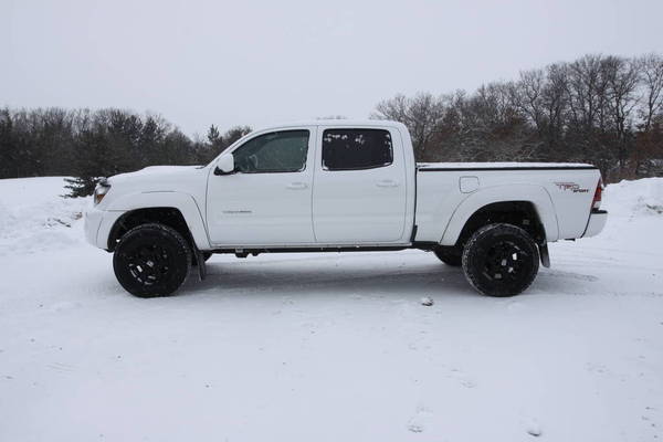

    Install went great, had automotive concepts in new hope do the work. I highly recommend them.
    The OME 884 is awesome compared to the 5100 at 1.75. TSB AAL made the truck sit like it should.
    Pics tomorrow...

    Old set-up: (1/2011)
    5100 @ 1.75 and TSB rear & 5100
    New Set-up: (today)
    OME 884 - 5100 @ 0 and TSB rear w/ Toytec 1.5 TSB AAL & 5100
    No vibes, awesome ride. Should have done coils to begin with.
    Will post pics in am, now just need bigger tires.
    It never ends...

    I got 2.25" front lift from the 884 (no top plate spacers). Rear is TSB with Toytec TSB 1.5 AAL. Tires are 265/65/17 for now. I love the ride, and the look. I wanted the back to sit up, and now it does. Highly recommend this set-up.

    Hey NFL lookin good. just got in now and looked at the pics.
