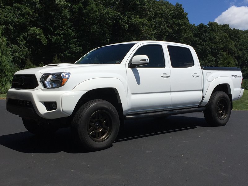

    image.jpg I had my 884's put on at 750 miles on my truck and it was sitting in the front a little over 2 inches. The front has sagged at 8000 miles and sitting about 2 inches. The rear is just a little lower but waiting some more miles before adding aal.

    Looks good, what shocks did you put on with them and did you add any trim packers to counter any lean? Or was there no noticeable lean?

    Thanks, I have the Bilstein 5100's bought them from Headstrongoffroad. I had them put the springs on and the spacer for the driver side taco lean. I plan on lifting the rear higher after some more miles are put on. Also I might have my mechanic set my 5100's on the second setting to raise the front a little higher.
