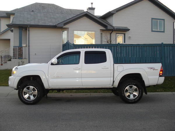

    Id like to see some pics too. I've got 5100s in the mail and now gotta decide what coils to get. Leanin toward the eibach coils currently.

    2017 Tacoma double-cab TRD Sport
    TRD Pro grill and fog lights, Toytec Boss lift, 265/70-17 Duratracs on 17 x 8.5 FN Verge wheels, LEER canopy, 30% tinted front windows.
    Pics in my gallery. Pay no attention to the ugly bull bar...it's gone now :)

    Looks good, What do you have the front set to? TSB in the back?

    2" Toytec AAL with no TSB. 5100's all around with the fronts set at 0.85 with the eibach spring. Got 2.5" in the front, and 2.25" in the back on a d-cab 4x4 short box. Much better than stock!

    Mine how it sits now. 2.6" of lift front. 2.25" rear. New wheels/ tires to go on in the Spring.

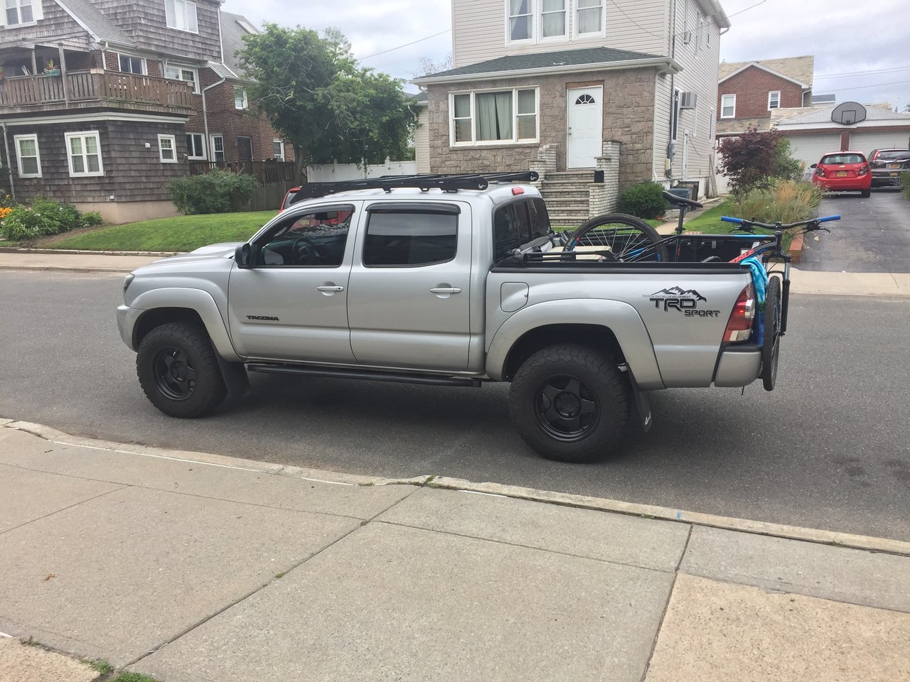

    I have eibachs 1.6 and 5100s set at .85. I plan on getting an aftermarket front bumper. I'm going to want to keep the same height (2.5ish) so what do you think is my best option with this added weight? I'm getting an alcan leaf pack with 2" lift in rear and want to keep front end as level as possible.

    adjustable coilovers with a 650# or 700 coil springs Considering the weight of bumper,winch, etc...some examples, Like icon,king,fox,etc

    I'm asking if I can get away with billies and the eibach 650 with a steel front bumper no winch. I'd rather not drop a ton of $$. Since I just bought a ton of shit for this truck
