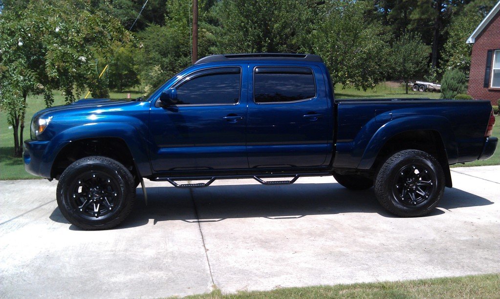

    Bama_TACO
    Bama_TACO ROLL TIDE!!!!!!!
    Aug 3, 2010
    #41157
    1,011
    Winfield, AL
    2006 PreRunner Double Cab TRD SPORT
    I have 885x and I have the 1/4" spacer on the driver's side along with 1/2" top plate spacers on both sides. Mine sits dead level now (side to side) and measures 24 3/4" from hub to fender. Rear is sitting at 26" if anyone is wondering.

    Bama TACO,
    With your measurements at 24 3/4, isn't that close to 5 inches of lift over stock??
  10. Jul 30, 2012 at 7:53 AM
    Bama_TACO
    Aug 3, 2010
    #41157
    1,011
    Winfield, AL
    I'm not sure. It had a spacer lift when I bought it so I'm not sure what it measured stock. I'm pretty sure I'm close to 4" if not a little over. In addition, I have measured several times because I keep questioning my own measurements. I'm measuring from the center of the hub to the edge of the fender, straight up.

    2011 TRD Off Road DCSB Prerunner Skeewped
    Yea, sounds like you are measuring it right. I don't 100% remember what mine measured at stock (I want to say it was 20" from center of hub to fender). If that holds true, then that would put you at over 4" of lift. Are you running 5100s set on anything other than 0 by chance?

  14. Jul 31, 2012 at 6:15 AM
    sfcadams
    sfcadams Retired Senior NCO
    Aug 13, 2011
    #61645
    1,439
    Dan
    Elizabeth, Indiana

    Zero
    Kinda strange man... is your spring plate up side down? The plate that sits on the adjustable clip and under the coil. Just checking cause that would be bad, other than that I'm jealous. Hows it ride? I have eibachs set at .85 and my truck rides like sh!t..need a good balance maybe.

    Bama Taco has 885's , plus 1/2" spacers , plus another 1/4" spacer driver's side , plus it's a Prerunner

    Mine is a prerunner too and I am running Maxtrac spindles with factory TRD shocks/coils up front and it sounds like he is sitting higher than I am. So those 885s provide almost 3 1/2 inch of lift then?

    885's can get a Prerunner up to 3" , plus 3/4" for his 1/2" spacers , plus another 1/2" for the 1/4" spacer

    Well the 1/4 spacer is just to get him up to par with the passenger side. I wouldn't add that to the lift dimensions....he's getting over 4" of lift with a set up that can yield at best 3.75". I still think the spring perch may be suspect. Worth a look, anyway.
