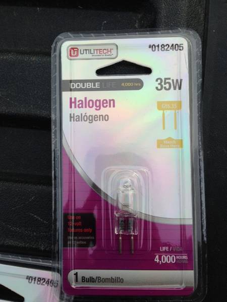

    Probably not, but a T4, G6.35 base, 30w halogen should be a stock item.

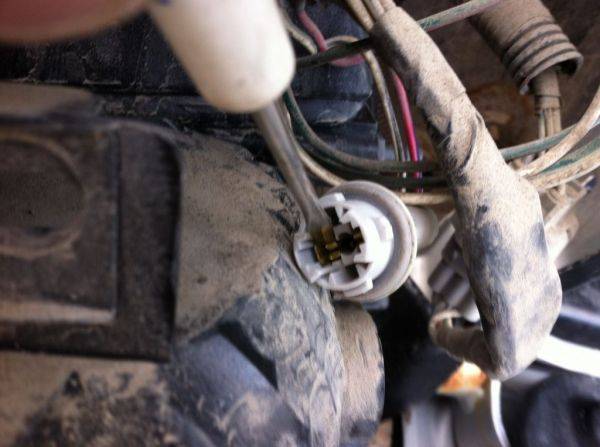

    Nice thing about the Philips lamp is no messing with getting it out of the 886 connector... Just snug your factory contacts together and plug it in firmly.

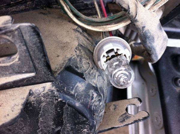

    You can likely find something at any big box store, 12v, <50w, 2 pin. May not be able to find twin packs, but I can assure you that you'll enjoy the convenience of simply snugging up the bulb holders versus breaking a single bulb... and you'll pay a lot less, even if you have to buy them individually.
    You'll also save money ordering them online too, 1000bulbs dot com or Amazon, wherever you want... if Home Depot is far away and you have amazon prime or need to order some other stuff (to the $ figure of being eligible for free shipping on other items in your order), go for it. Mine are still working great after the better part of a year, haven't had to open them up and snug up or anything. I've also removed my tail lights since then when wiring up my trailer lights, didn't even think about the fact that I had aftermarket bulbs in (until 20 seconds ago actually hah)... all is still well.
    Highly suggest people get away from modifying bulbs, stressing over clipping the wire, breaking stuff... especially with the picture above of melty housing. I broke two of the pricey autozones in about 10 seconds and still am sore about it hah.

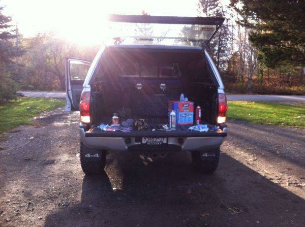

    Well went by lowes and picked these up and installed them just abit ago, HUGE difference between these and LED's I was using. Easy install and wish I would have did this along time ago.

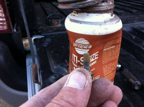

    Me too! :D
    Bolts were a little rusty so I anti-seized them!
    [​IMG]m/gallery/showphoto.php/photo/364282/cat/500][​IMG][/url]
    I'll get another one in the dark!
    Pretty quick and simple!
    THANKS ALL, for all the info!

    I must've not crimped the internals tight enough because mine didn't work and had to go back to the stocks, will have to try again next weekend.

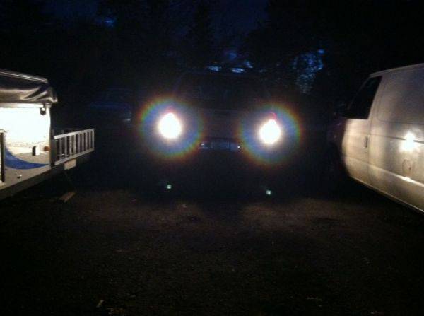

    Night pics! AWESOME IMPROVEMENT!
    I CAN SEE!
    Loving this! Thanks again all!:D

    ^^ looks good John yea since I've put those in I havent had to roll my windows down to backup anymore lol. It was pretty bad when you had to roll down your windows when you have a backup camera lol.
