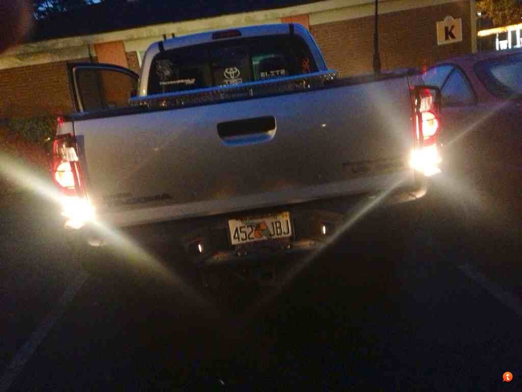

    After seeing someone post this mod on FB yesterday I couldn't wait. I went with the 886's. I cut them just above the rubber ring, folder the tabs over onto themselves to make a very nice fit in the connector. They are seriously bright! Great write up. I will add a few pics of what I am talking about in a minute.

    The picture of the truck. Factory bulb on the right, 886 on the left. Wish i would have done this sooner.

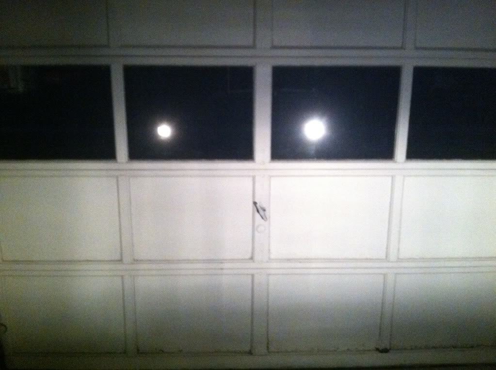

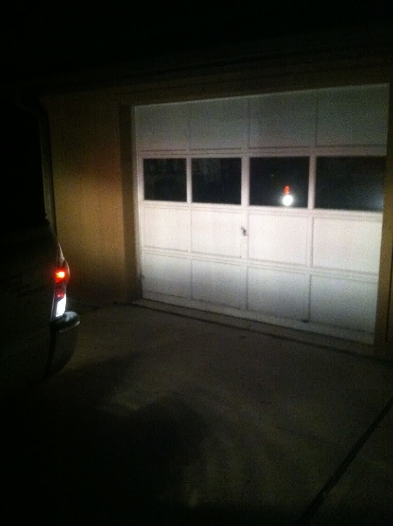

    Gotta get some pics when its not raining. Drove out behind my store after work to see how they did in the dark, they illuminate like 25-30 feet out behind the truck.
    I still want to add a flood light to the rear, but for a $10 and 15minute mod this was pretty cool.
