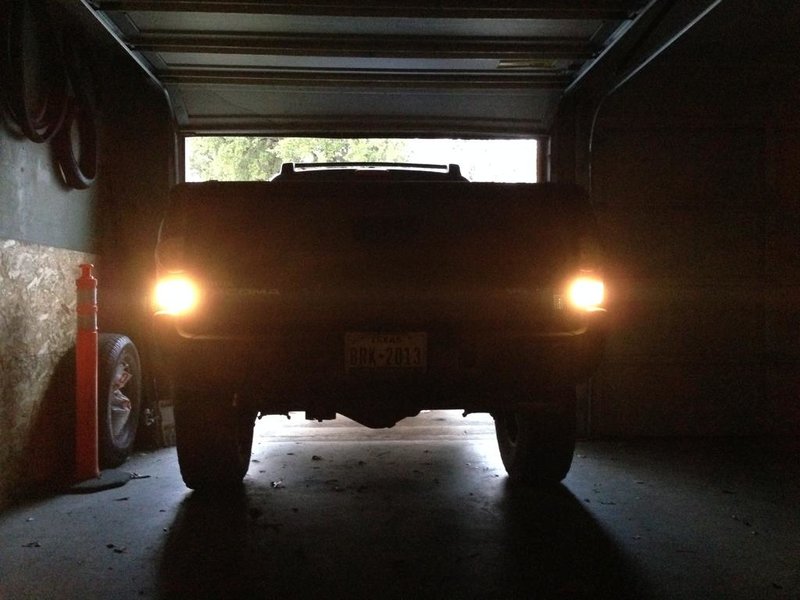

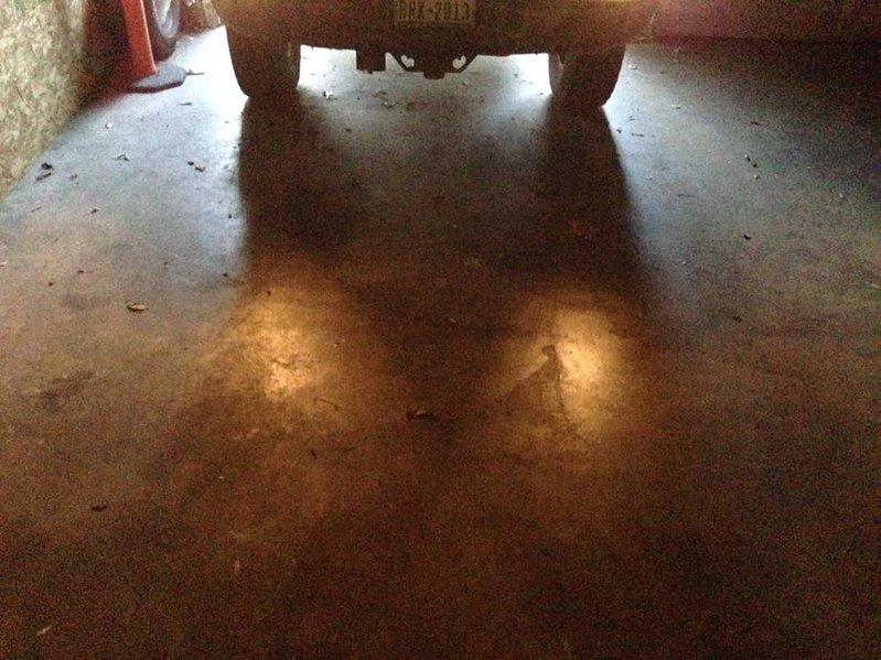

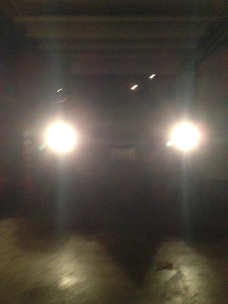

    Stopped by Autozone today on my way home from work to grab a pair of 886 bulbs (about $10 a piece).
    The mod took me a total of 20 minutes, most of that time spent being extremely careful as I cut the bulb leads from the housing they came in to fit in the reverse light socket.
    The first two pictures are of the stock back up lights and their spread in my garage. The third picture shows the difference between the two with the 886 installed on the left and stock on the right. And the final two pictures are with both 886 bulbs installed.
    These things are bright as hell! I have to say that I am extremely happy with the outcome and would do it again in a heartbeat.

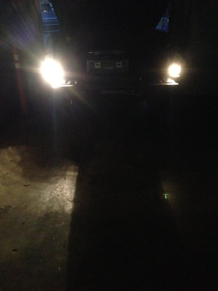

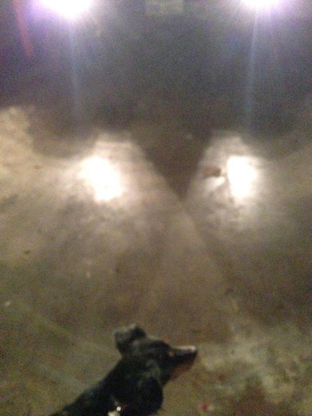

    Just put in a set of these:
    Easy peasy.
