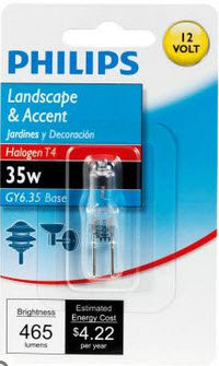

    A few things
    They have a few different types of bases that all look similar(Like GY6, GY6.35...). I used the GY6.35 (thats just the base size, not bulb spec) and it worked perfectly.
    I used these 30W(=50W) Halogen bulbs ($7.95 each) and all I had to do was squeeze the brass clips together inside the socket like everyone mentioned. The bulbs snapped in perfectly. The whole mod took me like 10 minutes. There are many different types of these bulbs at Home Depot with different brightness and believe it or not some of the 50W bulbs have less Lumens than these 30W HALOGEN bulbs which are 750 Lumens. The Halogen bulbs pretty much look just like the incandescent bulbs so look for the word Halogen on the package. Hope this helps.

    Just did this as well. No issues. I did put a lil dob of solder on the ends of the pins to make sure they don'tcome out .

    Just did this today...used some 893's...38 watts...works great!

    A few things
    I know right! I wasn't sure it would be much brighter since it's not as much lumens as the 886 or 896 type bulbs but 750 Lumens is plenty bright for me. And I'm not worried it will ever get too hot if I have to have it in reverse for a few minutes.

    I just did mine last night with 35w halogens ( they were free through my 2nd job ) and there was a noticeable difference. I'd like a lot more still but that will require some low profile LED aux lighting in a 60' flood pattern.
    Here's what I noticed the most. With the halogens, the filament position is spot on in the bowl of the reflector. This harnesses the light and focuses it outward much better than the OEM lamp. So now I have some more distance being lit and a little less flooding outward to the sides it seems.

    I used the GY6.35 Base, 35 watt ones from Home Depot.
