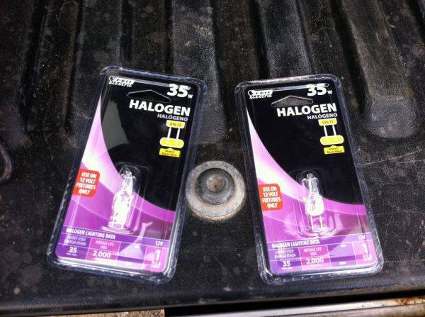

    Anyone had any issues with the housings melting from the heat of these higher watt bulbs?
  5. Feb 1, 2015 at 12:24 PM
    #305
    Yota64
    Yota64 Professional Threadjacker
    Jun 13, 2011
    #58237
    7,967
    AR15 someone in the first few pages mentioned a good point, the reverse lights shouldn't be on long enough to melt anything. Also none have reported an issue yet and this thread is quite old. I assume these are a cheaper option than LED replacements and cost less?

    What if you have to back up for a long period of time? Like a long driveway....

    I've had mine in for a while now and yet to have an issue and when wheeling I'm sure I've left them on for a while before.

    nope, but i am using the 35watt ones. Output is SO MUCH better than my moms 07 4 runner.... backed that thing up the other night and thought both reverse lights were out.

    Same here. Couple years with no issues with the 35watt! Plenty of long backups in the woods at slow speeds! All good so far! Excellent lighting!:D

    So what wattage should i go with? 35watt?
  11. Feb 1, 2015 at 2:51 PM
    #311
    Yota64
    Jun 13, 2011
    #58237
    7,967
    Sounds like 35 is the consensus.

    These are the ones I used! My understanding is the 50watters will be too hot, and melt the housings!:p

    So this mod can be done for under $20?
    I see none on Amazon that are halogen and are around 35watt

    No melting with my 894s (37.5 watt), it still makes smile when I shift into reverse after dark - every time. :) And it's been over two years. :thumbsup:
    I've left the truck in reverse with the engine off a few times to use them as work / loading lights a few times too, close to ten minutes continuously. Zero regrets on this mod here.

    Just ordered 3 886's (35w) off of Amazon. Doing this mod as soon as they come in. Backing up with the slide-in camper and reduced visibility will be much better now. Nice write-up and thanks for everyone's feedback and experience. TWFTW
