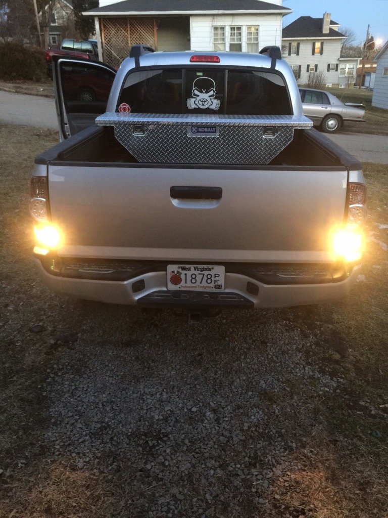

    I did mine today.

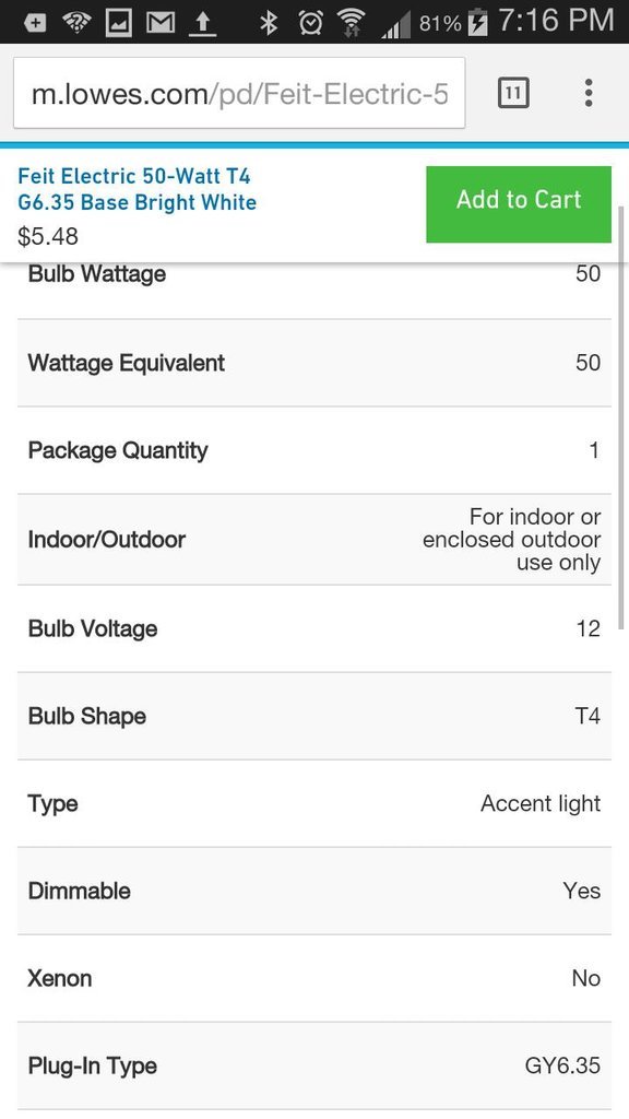

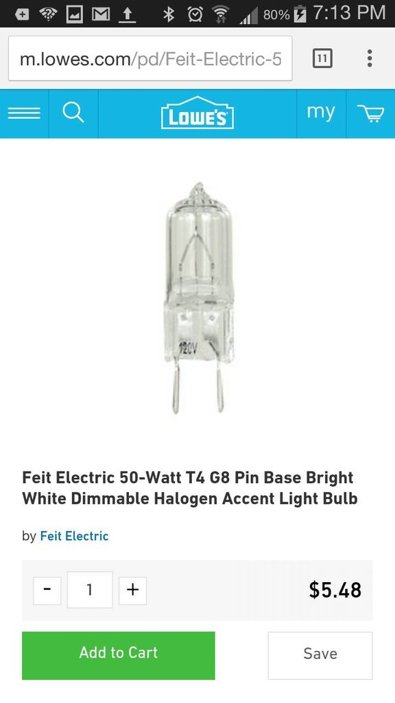

    Anyone know if these 50 watt bulbs will work?

    Those are 50 waters ERMB, there was some talk about possible issues with heat. But that is the wrong base. You want the GY6.35 base. 35 watt with the GY6.35 base will also fit. After reading this thread, it seems like a lot of guys run the 50 watt without issue. I guess it just depends on if you will be running the lights for extended periods of time.

    I mixed up my pictures. The description goes with the correct bulb though. Thanks for the info, now I know what to pick up tomorrow:D

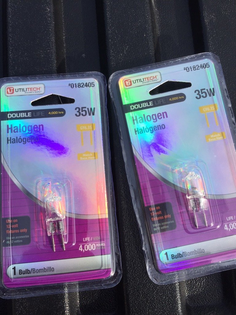

    Picked up the gy6.35 35w Utilitech bulbs at Lowes yesterday, on sale for $4.78 each. Makes a big difference. With the topper, tinted windows and living in the sticks, I need all the help I can get.
