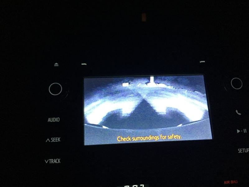

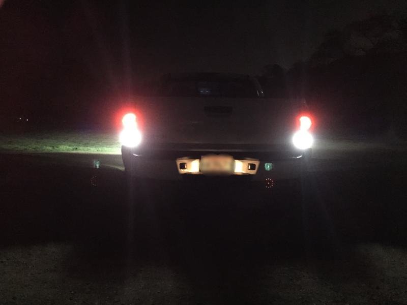

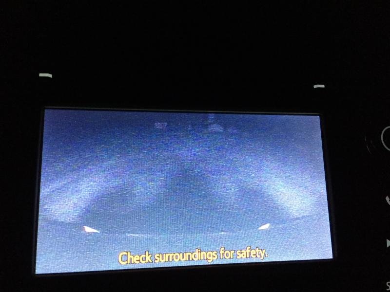

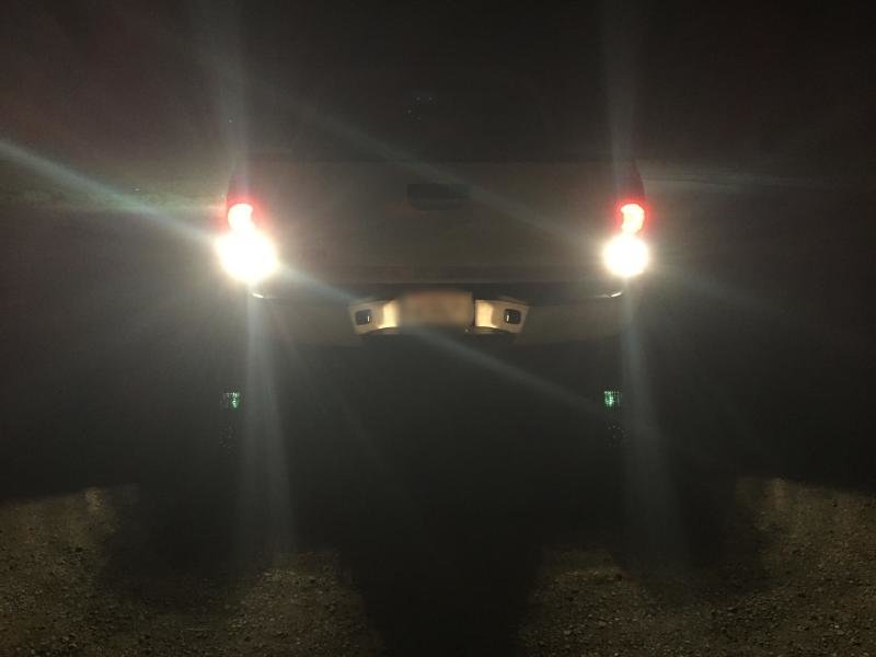

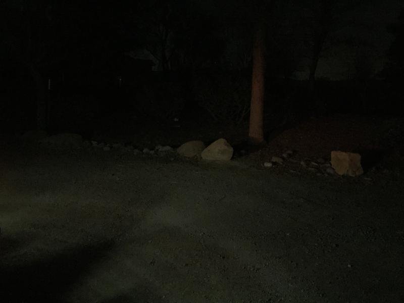

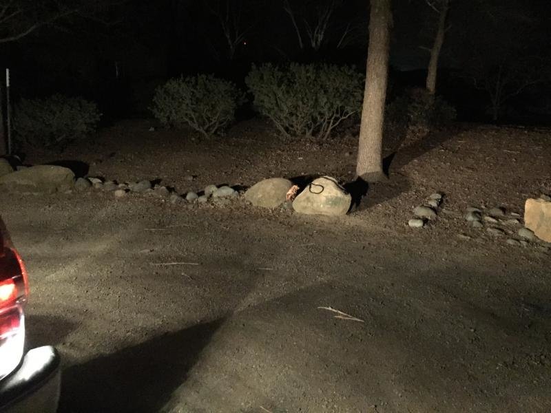

    I like threads with lots of pictures so here are some more. First ones are shots with LEDs I had put in so I don't have a stock comparison. Bottom pictures are with the 35W halogens from Lowes shows on the previous page of this thread. I've only used them to get the pictures but think they will make a big difference
