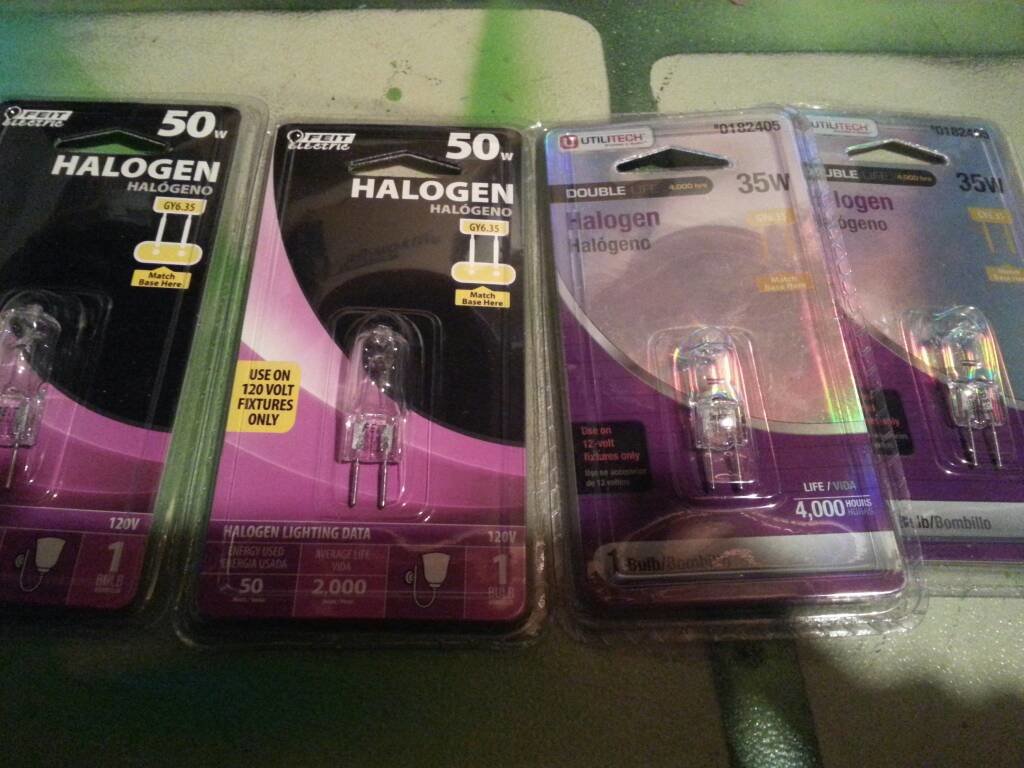

    Just bought these today while picking up the new snowblower. Didn't realize till just now bought the wrong 50 watt. Wanted the 12v not 120v.

    Use the 35watt.
    Not the 50watt.

    Yeah, just went back through the thread and read up on 50w and nope won't be using those, thanks
