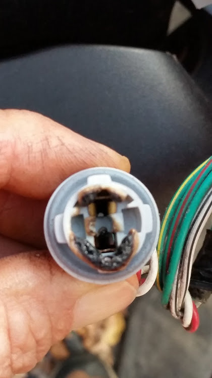

    hot to put in? Why was the light on when you were putting it in? Did you at least use gloves or wipe the bulb off after you put it in? On a side not I did this a little over 1.5 years ago gonna have to check them out. They look like the stock lights. Can't see a dam thin when backing up in the dark.
  2. Nov 7, 2015 at 12:06 PM
    #442
    DBF
    DBF Well-Known Member
    Sep 3, 2012
    #86140
    78
    2012 Tacoma, 4x4.base model, access cab.
    Yeah, I did put it in with the truck in reverse, NOT running of course. Kind of had to do it that way being that the connection wasn't great being that the socket was burnt up.
    I used nitrile gloves to install the bulb. But, it did heat up real quick once it lit up.

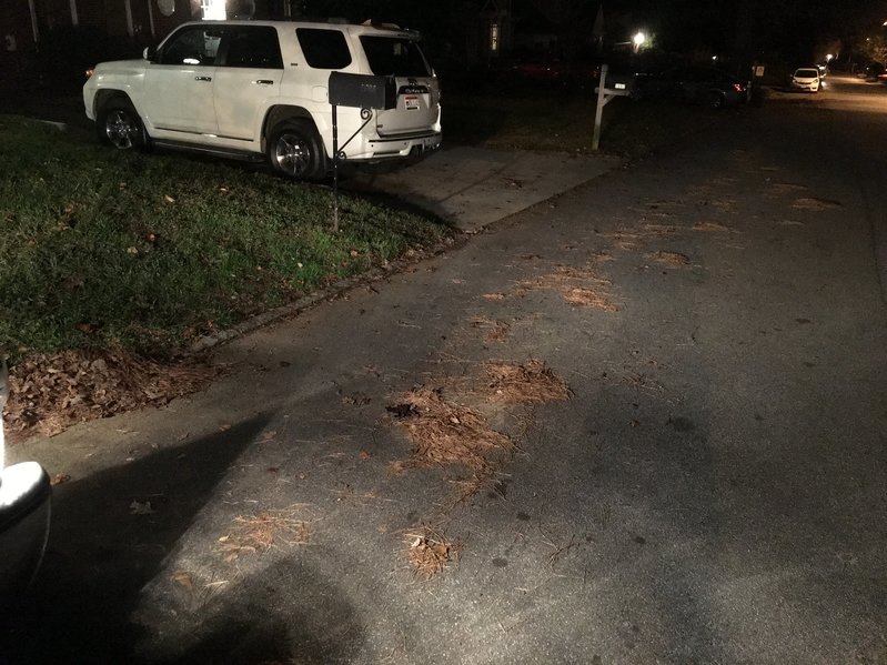

    20151112_174340.jpg20151112_182155.jpg before and after 886

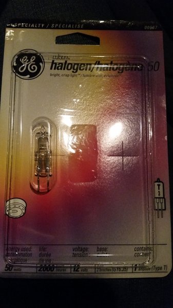

    Just did this tonight, used GE 12v 50 w gy6.35 rated for 950 lumens. On clearance for 4 bucks each at Canadian tire. They are the style with just the pins, just cut about about 1/8 inch off each pin and pinched the connectors in the socket and slid them in. Nice and tight. Glad I found this mod, I've got tinted windows and a topper with tinted windows. What a huge improvement, highly recommended. I left them on for three minutes and had no ill effect. Good to go!
    I used 35w

    Not that I have seen might wanna skim this thread..That pic of the 50w damage was posted a page or so back..I have 35w 12v pin style no issues had them in a year or so

    Here are the after photos lighting up my sisters 4Runner. I did it during the day so I don't have before pictures. This was the 35w bulb as seen on page 14 from Lowes. Works awesome
