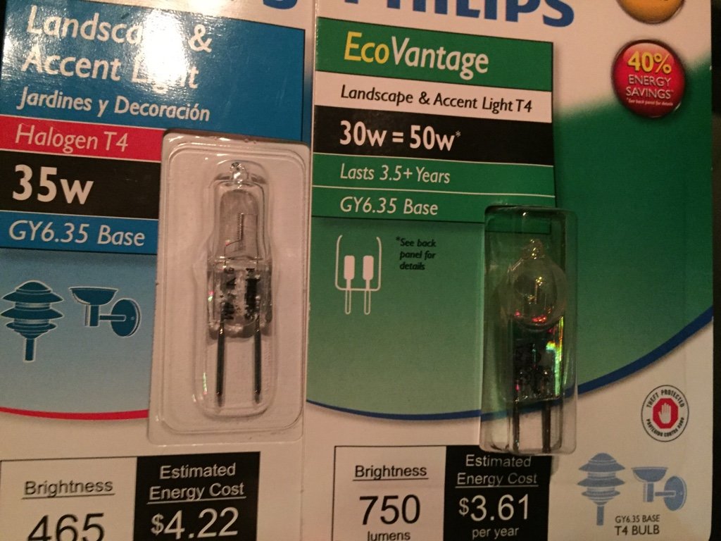

    anyone ever use these??

    might get the 35 watt i dont want to mess with 50 watt

    I bought those a week ago but haven't installed them yet because I'm waiting for a shipment from jumper LEDs. I talked to 2 different guys at Home Depot about those and they should run cooler than any 35 watt bulb.

    Did this yesterday. 35 Watts from eBay. 10 pack for about 6 bucks. Broke one while trying to snip off 1/8". Two went in without issue. Looks good so far. Nice and bright. I now have seven spares.
    From eBay: Pack of 10, Ultra Halogen Bi-Pin 12V Volt Replacement Bulb (G4, G5.3, GY6.35) (111768611496)

    I went to HD this evening out of stock & website says "Discontinued"!?!?!?!?
    The FEIT ones are 595 Lumes, Phillips Eco's 750. What are the stock bulb lumes?

    Guess I will have to go W/ These. Are the 10mm bolts to remove the light Assy. at the top??? My FJ was different.

    Yup. I ordered four a couple days before they changed the website. Looked to me like HD was Philip's only retailer for that bulb.

    Can anyone else who has been running the 886 bulbs chime in? We've seen two issues with charring/melting but haven't heard from anyone else who has been running them for a considerable time period. I put 886 bulbs in this afternoon and will probably order the GY6.35 35w bulbs based on what I've seen here.

    Did this mod today using Philips GY6.35 30w=50w Landscape 12v T4 light bulb 750 lumens... So far so good! Great light output.
