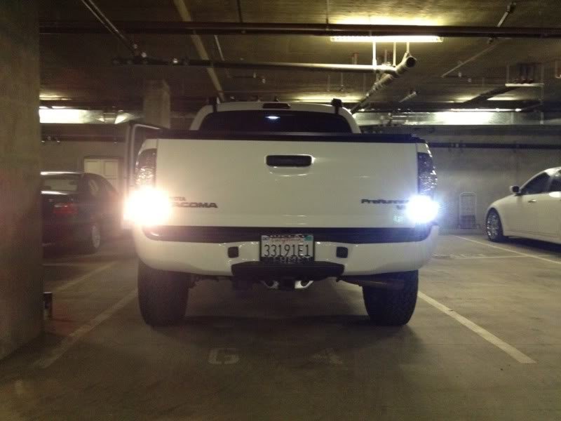

    Huge light difference, I will try and get a pic of my back up camera tonight. You can actually see the light cutoff where the 2 reverse lights intersect. Very bright and I can see in reverse with my windows tinted.
