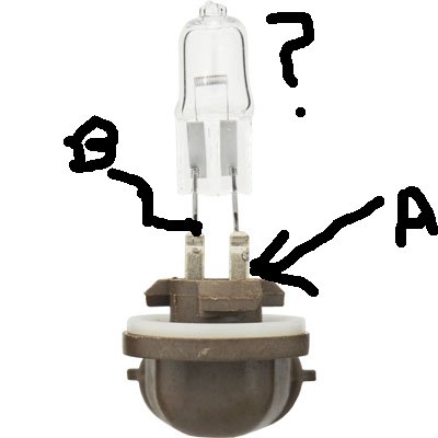

    78
    2012 Tacoma, 4x4.base model, access cab.
    Quick question. Do I dremel cut the bulb at A or B marked in this picture?? Or somewhere else?
    Thanks.
