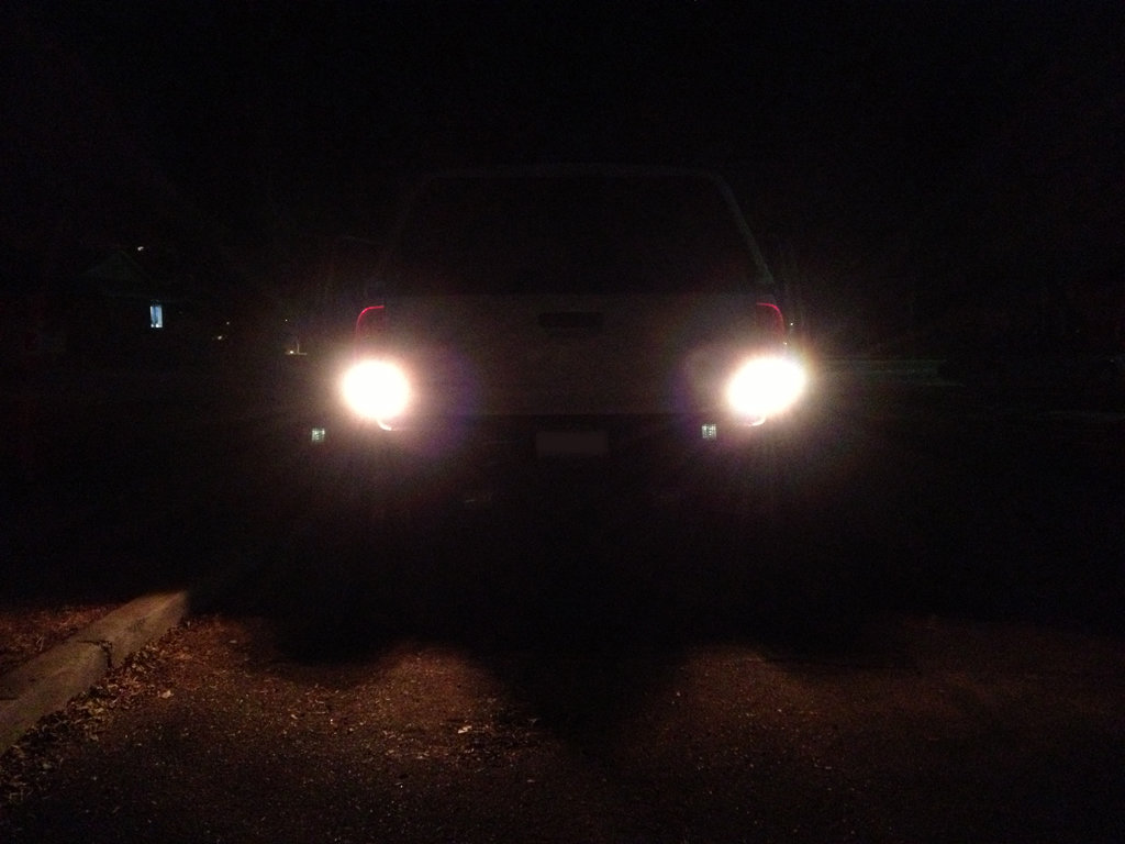

    I got dikes/diagonal pliers as two or so people mentioned in this thread. Immediately broke bulb #1 despite how 'controlled' i tried to be while applying pressure. After clipping one post the entire bulb was off the base, so I guess the force of it actually getting through was so severe that it broke the opposing post off the glass. I had enough exposed metal to consider resoldering the post back on.
    Proud that it could be salvaged, I vowed to do the second bulb perfect. Nah, son of a bitch did the same thing but this one didn't have any metal exposed from the neck of the glass. I had no clue what to do about that so i crunched it a little with the pliers trying to get even the tiniest piece of glass to crack off and allow solder. Naw, the entire bulb bit the dust a second later. I have never been to a strip club but assume $15 would last me longer there than it did with my bulbs.
    I went out and got some similarly priced halogens from home depot, GY6.35 base that I was blabbing about a couple posts ago. Worked perfect. Bent the receiving end in the socket to accept narrower posts from the bulb, 30 watts, 750 lumens, insane life expectancy. I will be ordering the best 50w bulbs (by lumen output) that I can find online that require no cutting and never think of my blunder again. Shit, I didn't buy another rotary tool just for this mod because too many people still had problems - surely the dikes would be the solution? BAH.
    Link to my install thread/writeup - where I also installed aux backup lights. No fear.
    Both the 30w Philips and 75w Philips work. I installed a 12gauge wire from battery to relay back there so I could have gotten away with the 75s - I'm seriously not in reverse that long because of having manual transmission and always trying to stay off the clutch. They'd never melt the housing. Ever. They just have shit lumen output for their wattage. Anyway, here's the whole shebang and conclusion of my afternoon laying in the dirt/30* weather.
    Congrats to those of you that pulled this mod off successfully, I'd still like your bulbs, I'd just flip out to crap away $15 in 15 seconds for the second time. Knowing this straight pin g6.35/gy6.35 end works perfect I'm pretty sure I can find some bangin' bulbs on the interwebz.

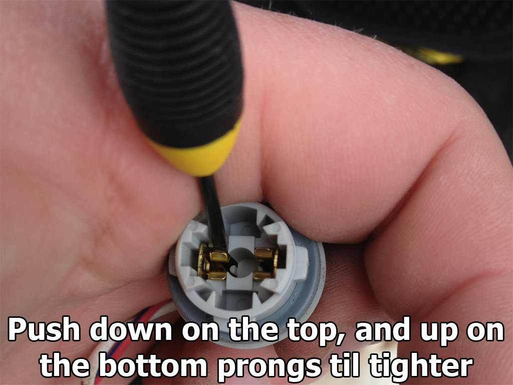

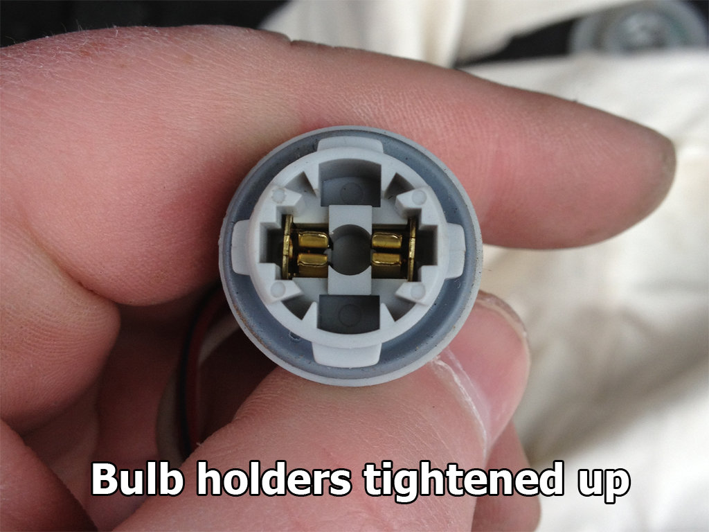

    I just did this. You dont have to bend the prongs..Just take a small screwdriver and kind of push the terminals in together on the connector for a tighter bite on the light.

    Yup, like this - took pics of process for my writeup thread

    That's perfect.
    Going to grab a set of 30w lamps from Home Depot.

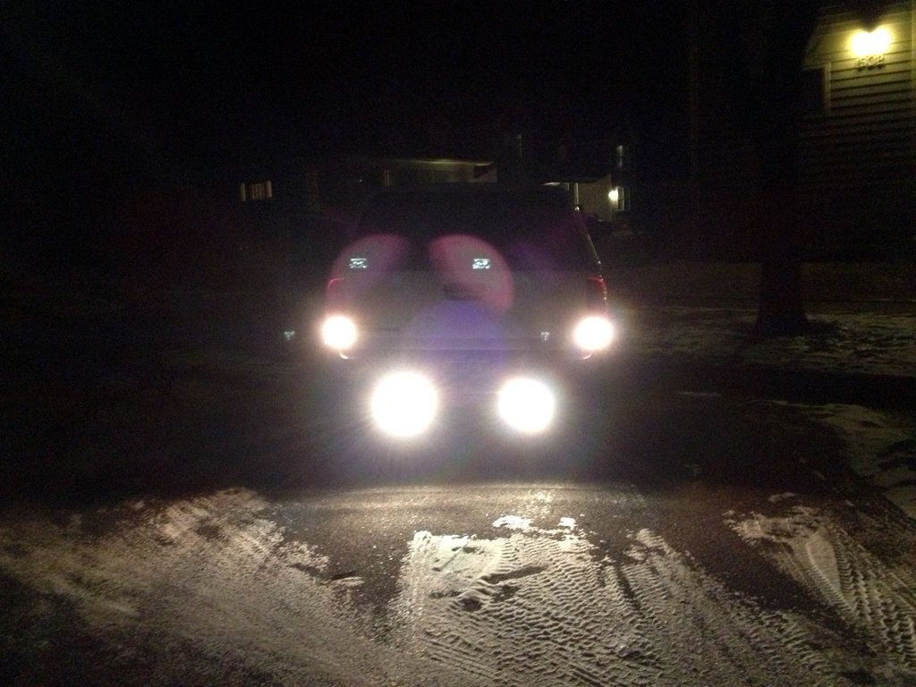

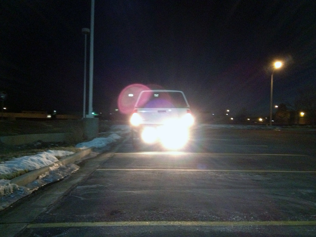

    These (http://www.homedepot.com/h_d1/N-5yc...eyword=30w+halogen&storeId=10051#.UPpHlGfjEbI) claimed to be a 12 pack according to link. It sounded really too good to be true. Yea, it was $15 for two bulbs lol. I still like em tho-
    Life: 3.7 years (Based on 3 hrs/day)
    Took some pics of lights again tonight, shoulda put a switch on those damn 55watters so I could keep posting more pictures of these 30w "50w equivalent" bulbs. Too easy.

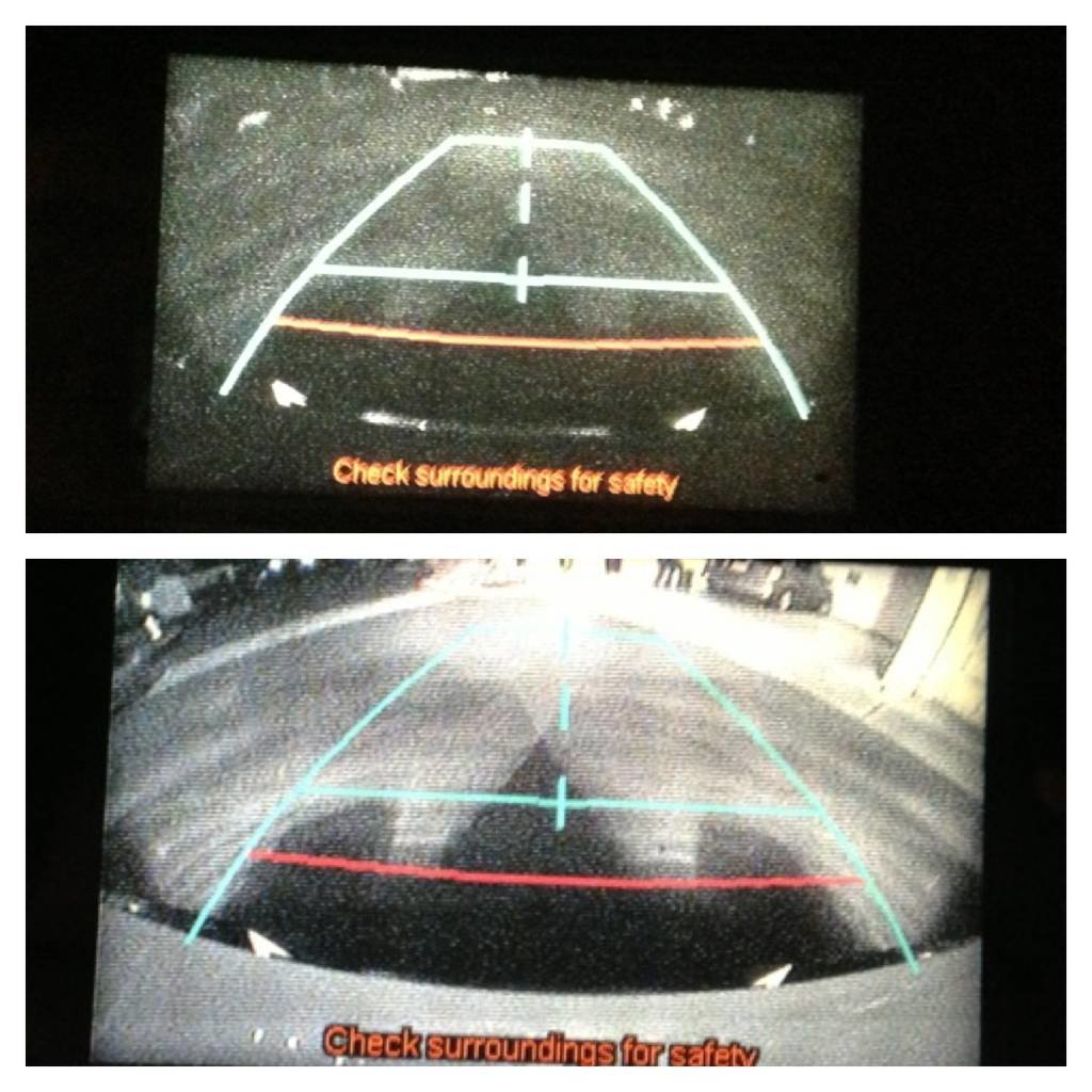

    I used 885s
  20. Jan 19, 2013 at 6:39 PM

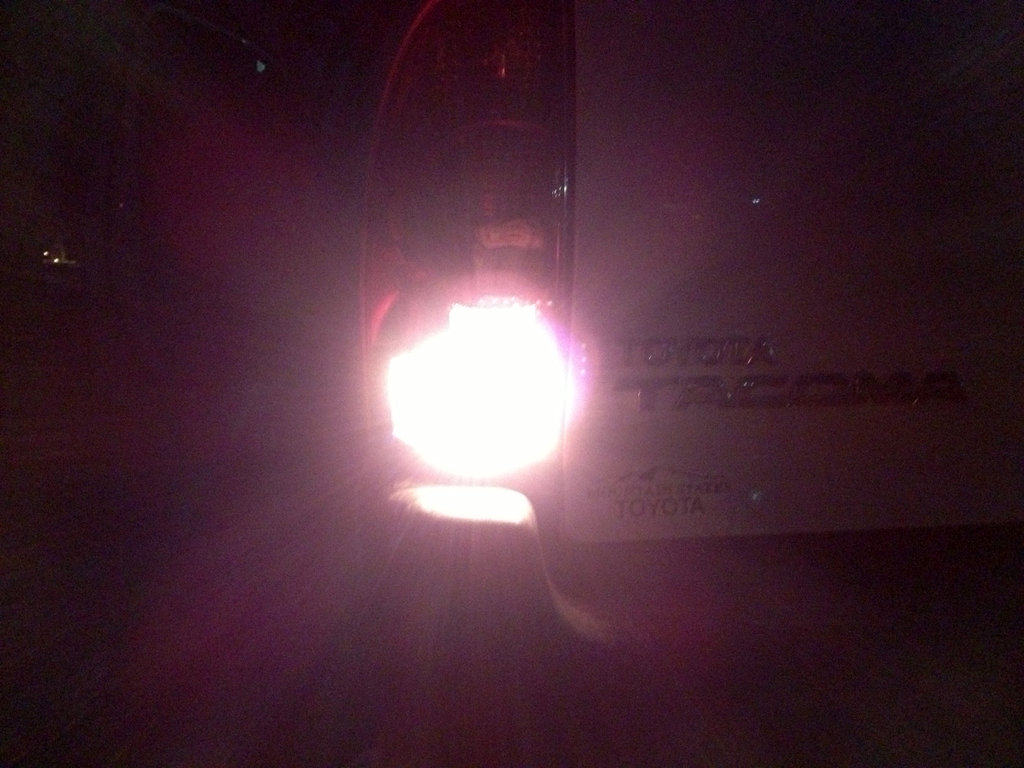

    Well :D
    read this morning, went to Home Depot after checking stock in store online. Purchased three lights, (always buy one extra just in case).
    getting ready for off road trip next week, and this was on my maybe list.
    Did the first one as demonstrated above, went so quick and easy, was feeling pretty good about myself.
    Soooo, I had purchased three of of the 886 bulbs a while back, broke two within five Minutes trying to bend the tabs back so they would hold in the socket. After waking up from the dead, and simply squeezing the contacts together as explained, (head was sleeping on that one) decided, heck, why not try the one left over 886 bulb.
    Cut the contacts just above the base with wire cutters, bent back and forth a couple of times with needle nose pliers being careful not to touch the bulb. Pressed the socket contacts together, and installed.
    Had to run to the store, and when backing out, cars actually stopped, must have had their attention.
    So I have one bulb at 750 lumens, and the other the 886 with 1256. To tell you the truth, they both look pretty darn close to the same.
