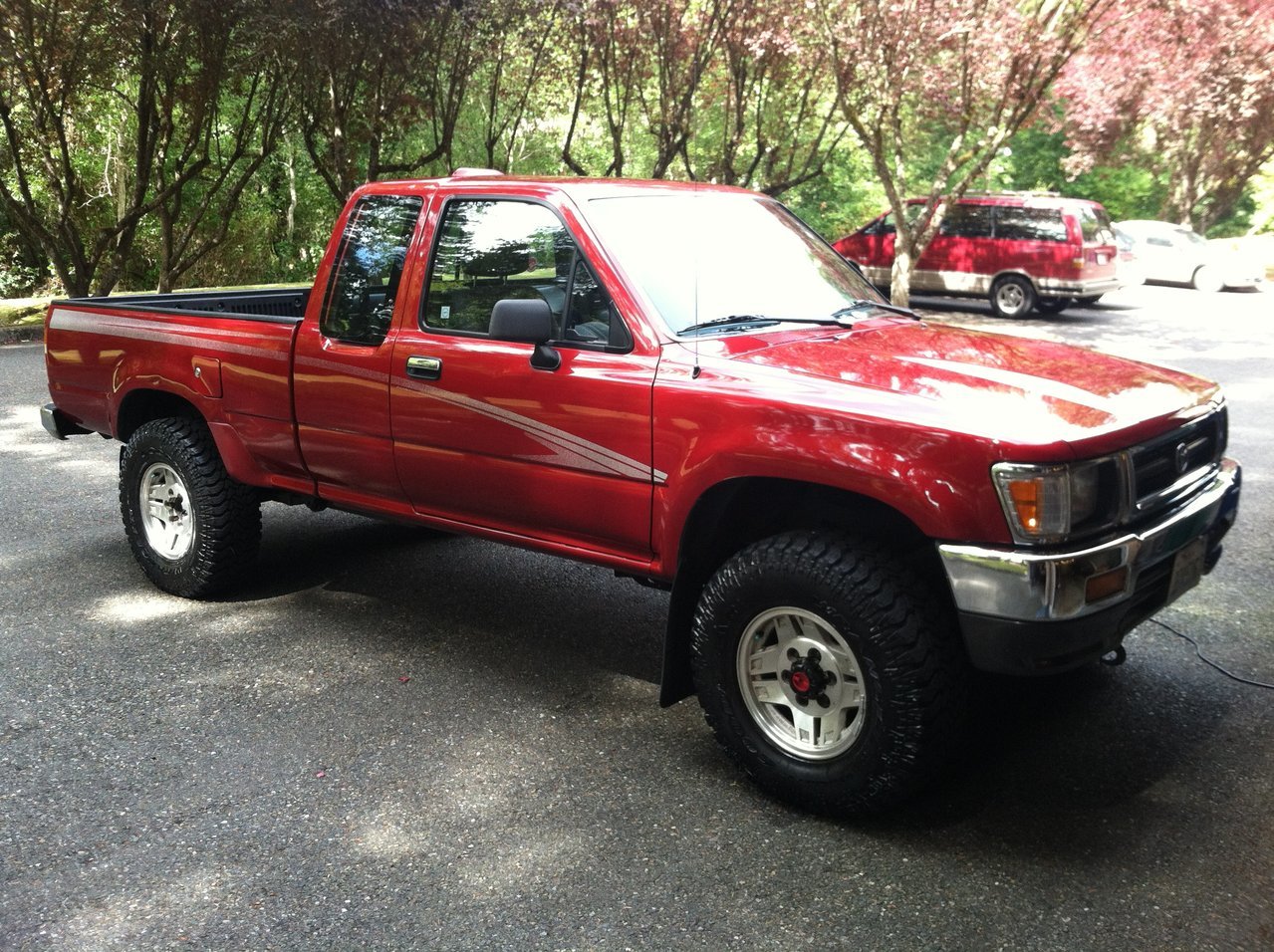

    A bit late but 31x10.5 will fit. Here they are on my 94, ran the same setup on my 89.

    Nice; doe's she rub at all on stock height? I don't mind doing minor trimming but finding a lift for the 89's is next to impossible now days and when you do find one they want an arm & leg for kit + shipping

    I swapped the stock steel wheels for the SR5 alloys, but the SR5 wheels plus 31x10.5 duratracs did not rub at all. No trimming required. I think the early 4x4 trucks had a good ride height and don't need a lift.
