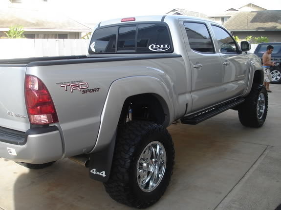

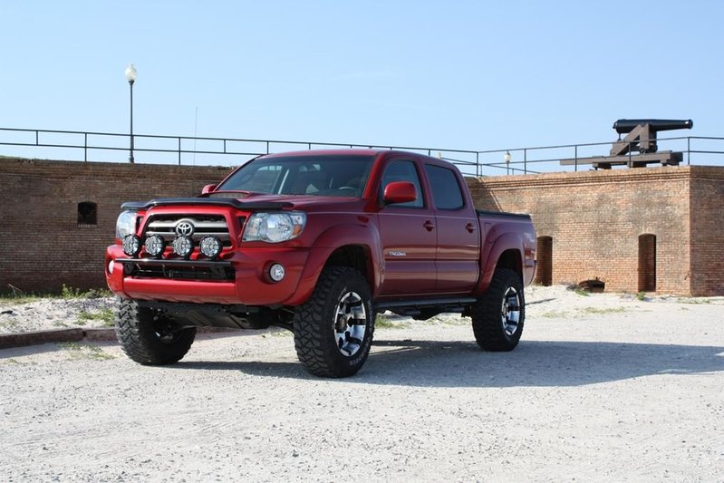

    The 2 attachments are what i would like to go for VISUALLY, now what goes into it performance(type of lift etc) is what im looking to mess with. i think the silver may be 2 high, if so, the red?

    the silver one looks like a 6", so you will be in the area of the red one. The lift you get with the kit is different for the back and the front. The coil overs are going to give you 3" of lift in the front but the add a leafs will only give you 2" in the back. One reason you would want a brand new leaf pack is it will give you more then 2". Because the back is a solid axle you can lift it sky high (reasonably) without any real consequences like you have on all of the IFS parts. So you can get 3-4" out of the back no problem, so why not. An all new upgraded leaf pack will also give you a lot better flex and shock absorption and travel over the stock pack with an AAL. The AAL is not always a permanent fix, becuse it is supporting the stock pack it will wear down too. You will get more life out of an all new pack than the stock one.
