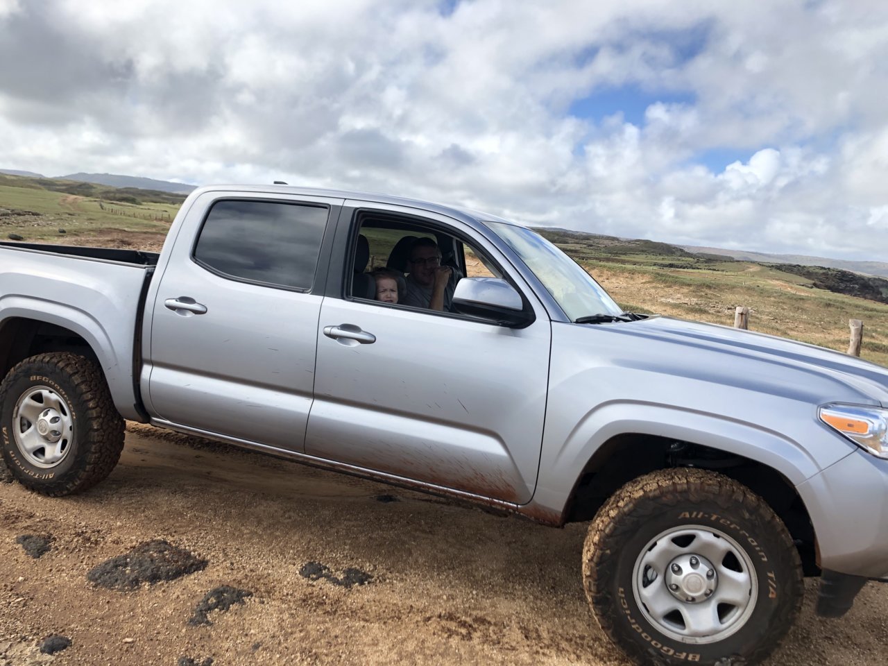

    I live in rural Hawaii. We do a lot of deer eradication (invasive species and all). This morning for example, I drove 10 miles at 45mph on pavement (our max speed in our area), and then 50 miles of about 50% 4wd, and 50% ungraded dirt road (a trophy truck would be bitchin for these parts).
    We loaded out 18 deer worth of meat (about 1200lbs) with 1 driver, 2 250lb hunters in the back. So the load varies, of course we go more slowly when coming out of the hunting grounds.
    The truck does ok, but the front dam scrapes fairly often, and the suspension feels really mushy (granted I bought the cheapest one) on the more loamy higher speed sections. I would like to do a suspension lift and am willing to pay the price for a Fox or Icon setup. I also see much less expensive TRD pro take-offs for sale on the used market, and wonder how much better the premium kits really are in the real world. I also do not want to cut anything.
    I did use the search function, and tried to find some really heavy everyday users and their setups, but came up short.
    If anyone has some real world experience with this type of build, would be most appreciative.
