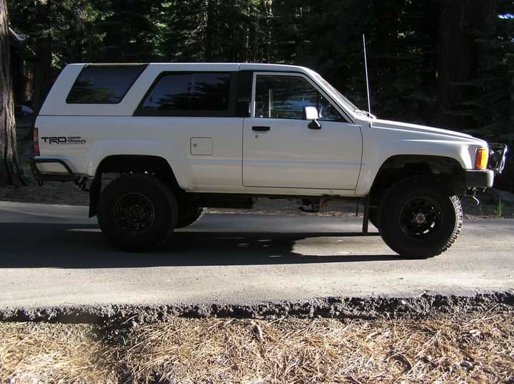

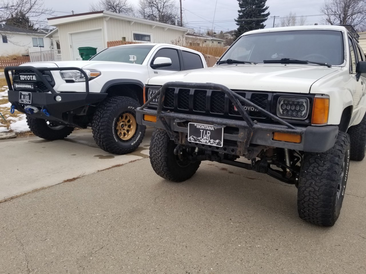

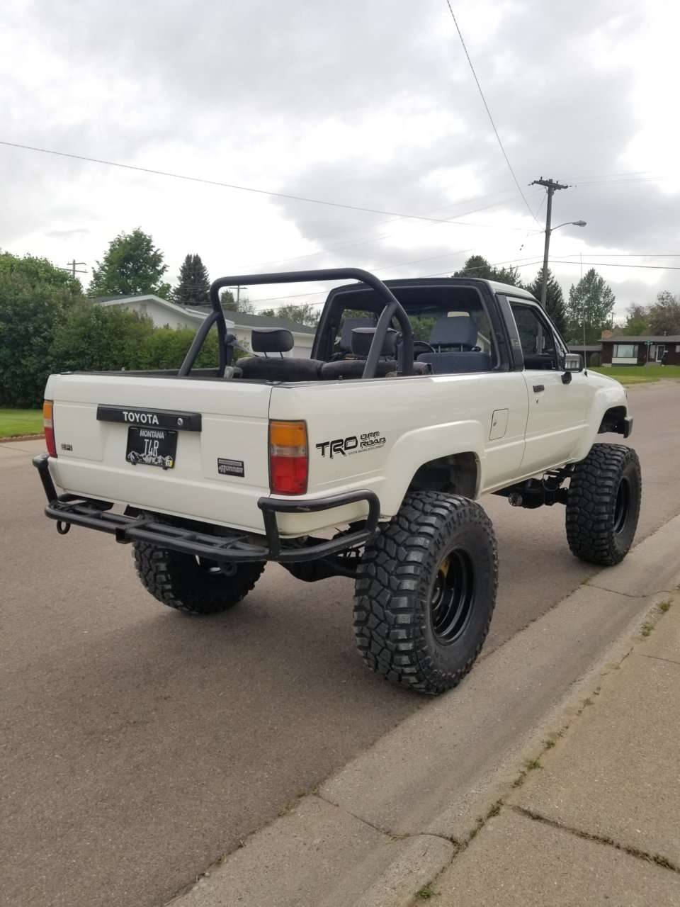

    I'd like to start off with this has been my dream to build my 1st gen 4runner. I bought it back in high school in 2008. It was pretty gangster with bfg racing tires on 18 rims. Shortly after I added some bfg ko's on black steelies to make it look better. In 2010 I joined the the military and gave it to my brother @Aguirre56 for his 16th birthday. Well fast forward 10 years later, I have the keys again since my brother bought @misdirection1982 4th gen LT runner. Its finally becoming reality.
    Motor:
    22re
    260k miles
    LCE header
    LCE intake
    LCE pro torquer cam
    Suspension:
    83 Toyota pickup axle
    Trail gear 5in springs front and rear
    Armor:
    Marlin crawler diff armor
    Marlin crawler axle truss
    Marlin crawler knuckle gussets
    Trail gear rear bumper
    Steering:
    Trail gear high steer
    Trail gear trunnion bearing eliminator
    Wheels/tires:
    Cooper STT PRO 37x13.5r17
    SCS F5 17x9 matte black
    More to come

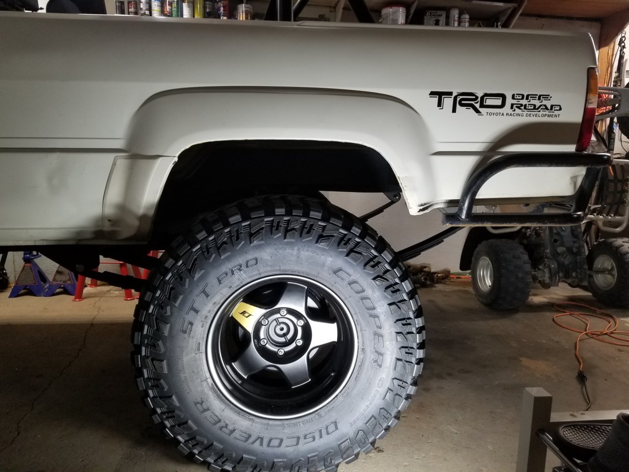

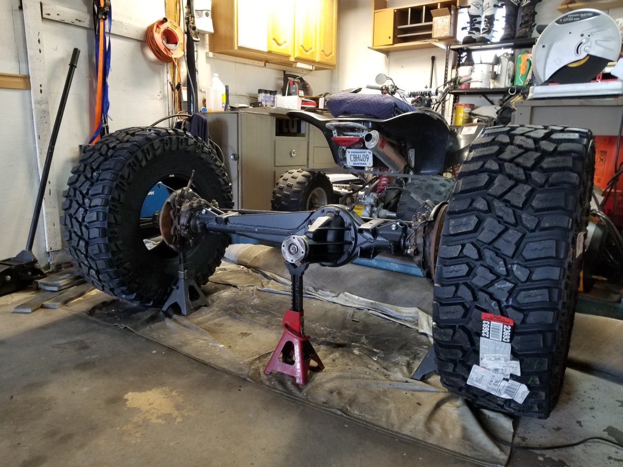

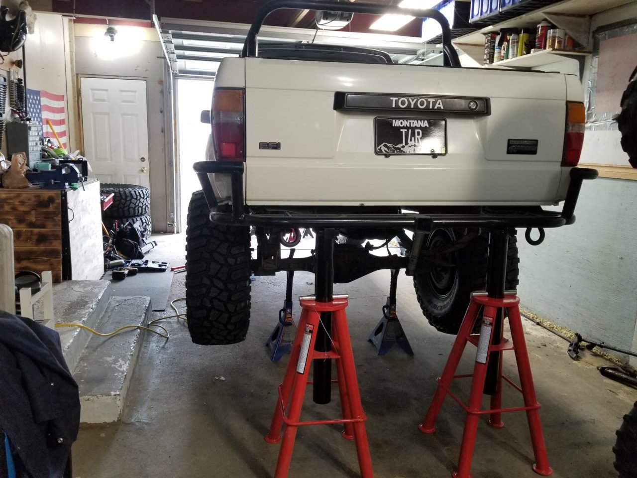

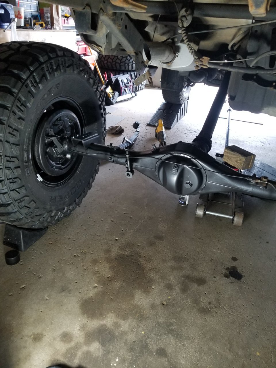

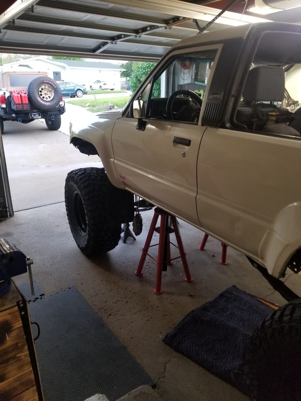

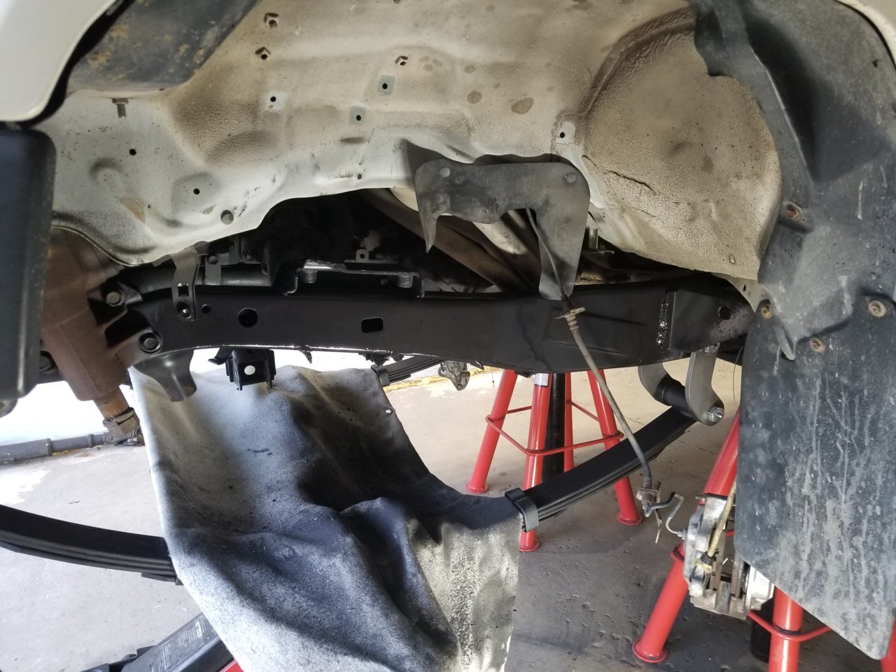

    Did the rear lift tonight I still need to weld on the new spring perches to correct pinion angle and shift the axle a hair back.

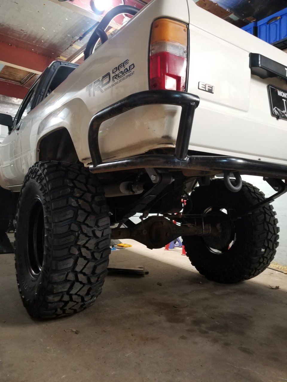

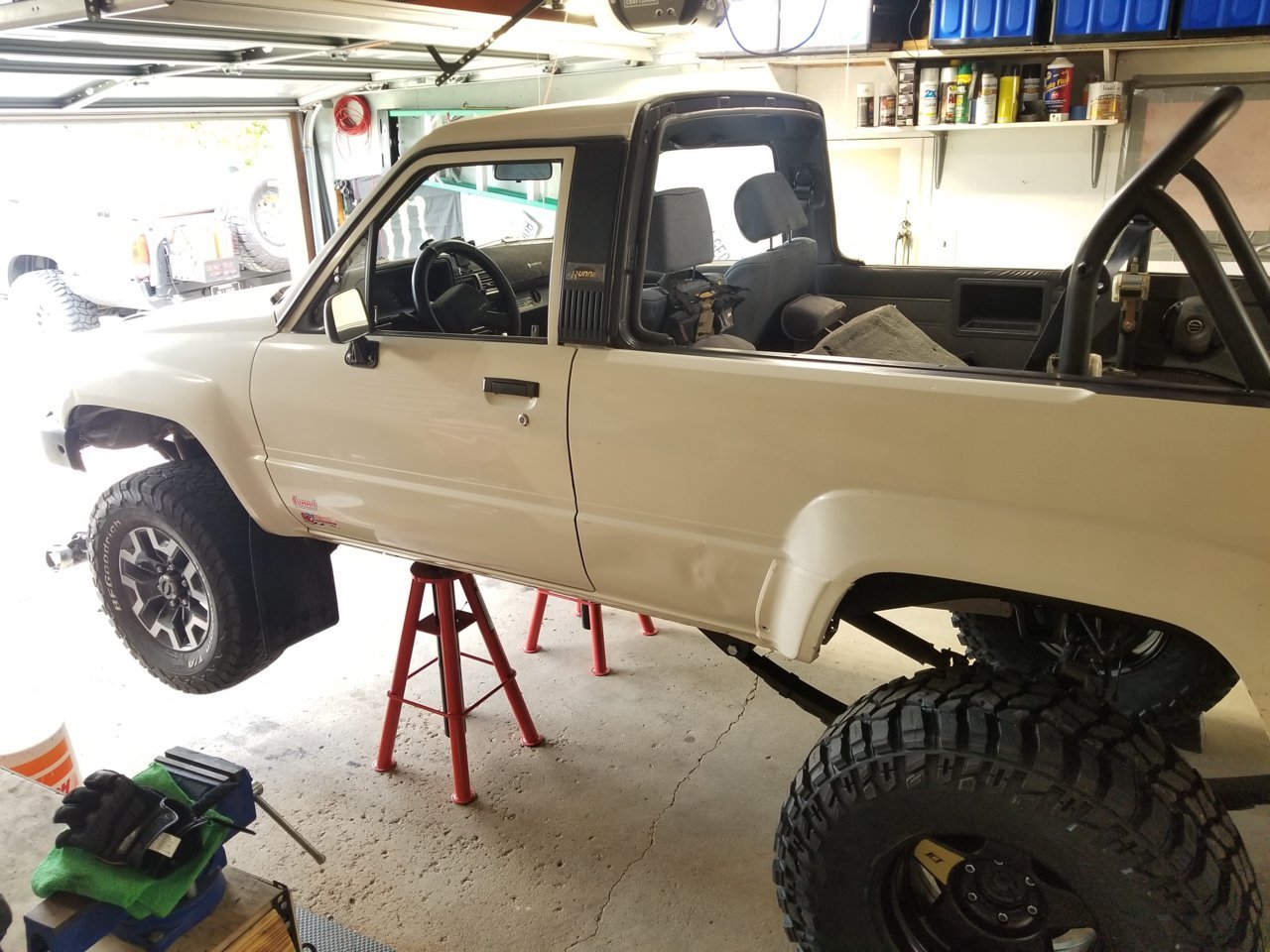

    Spring perches welded up and pinion angle fixed

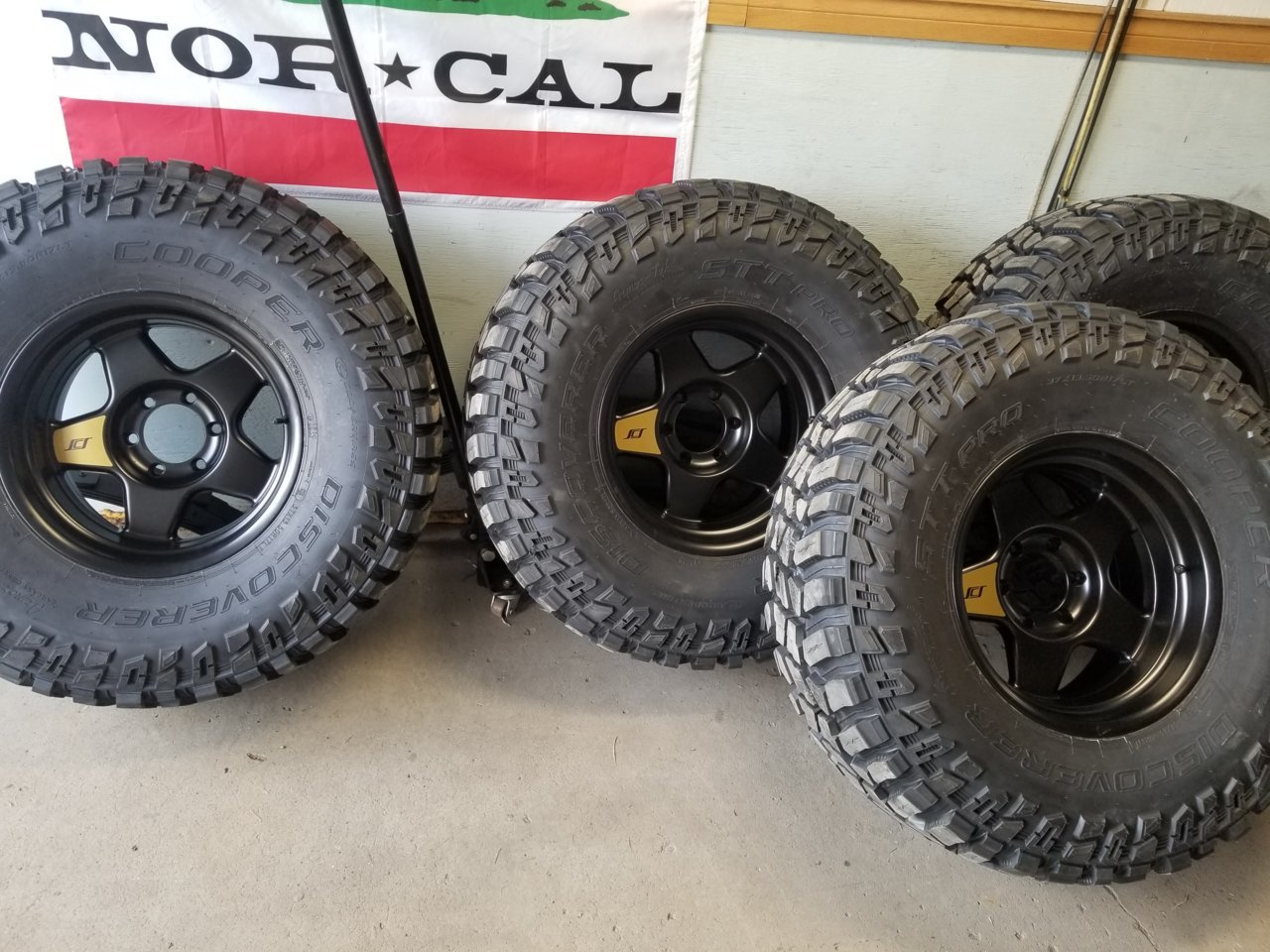

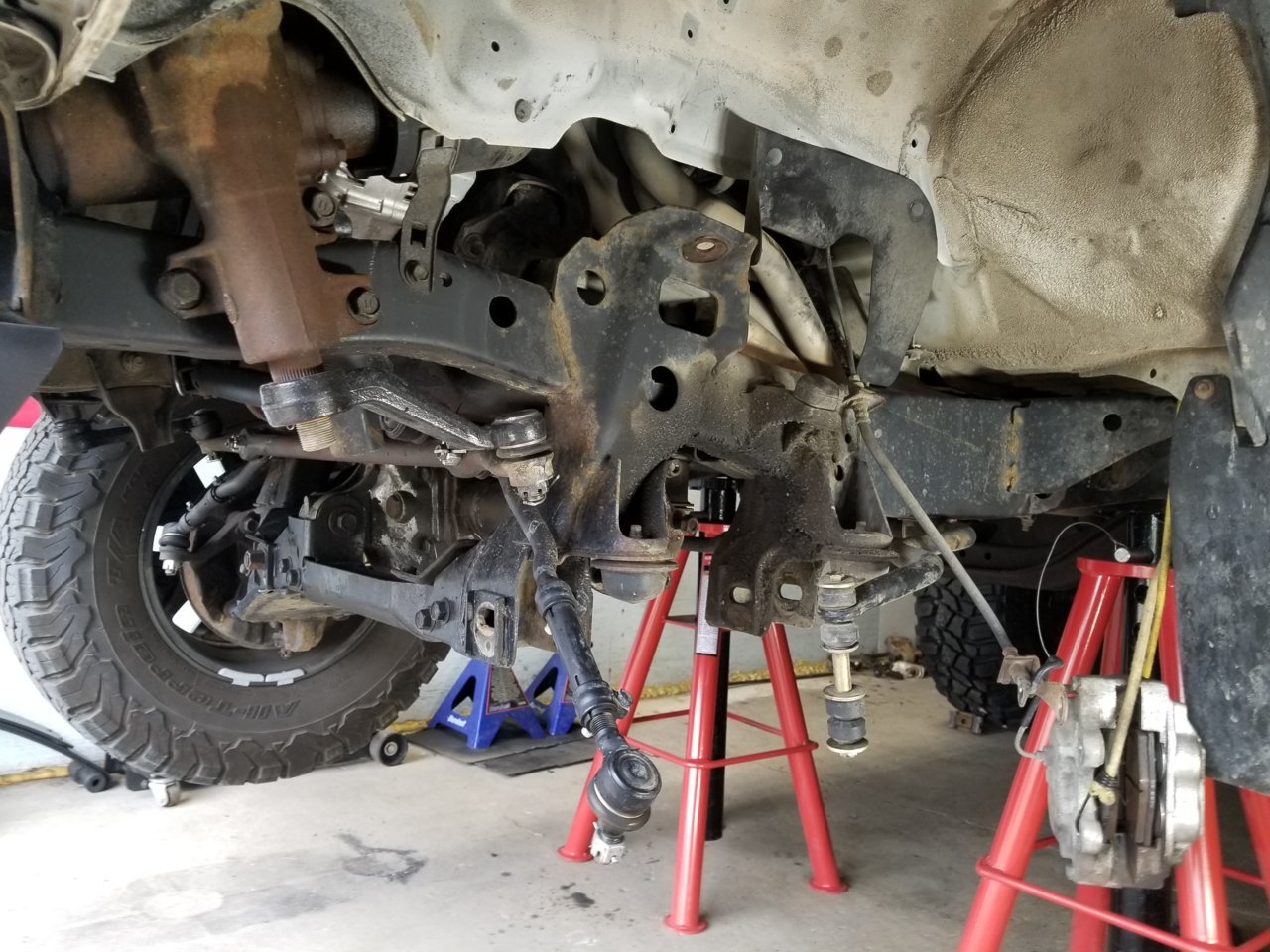

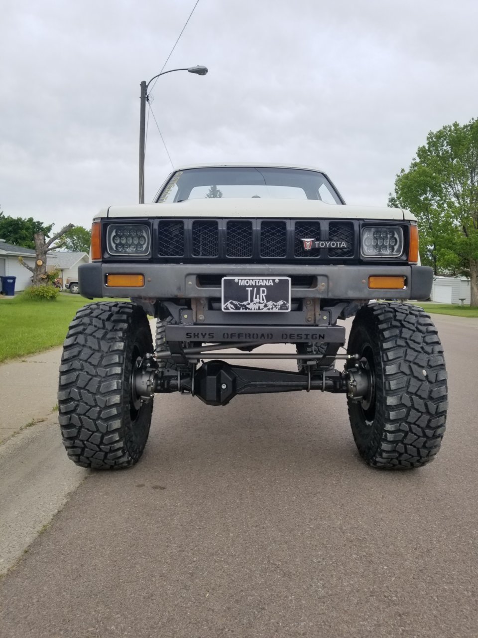

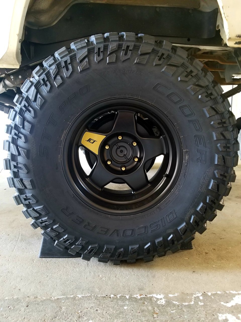

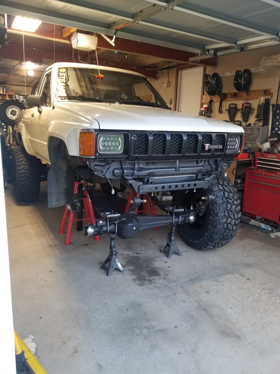

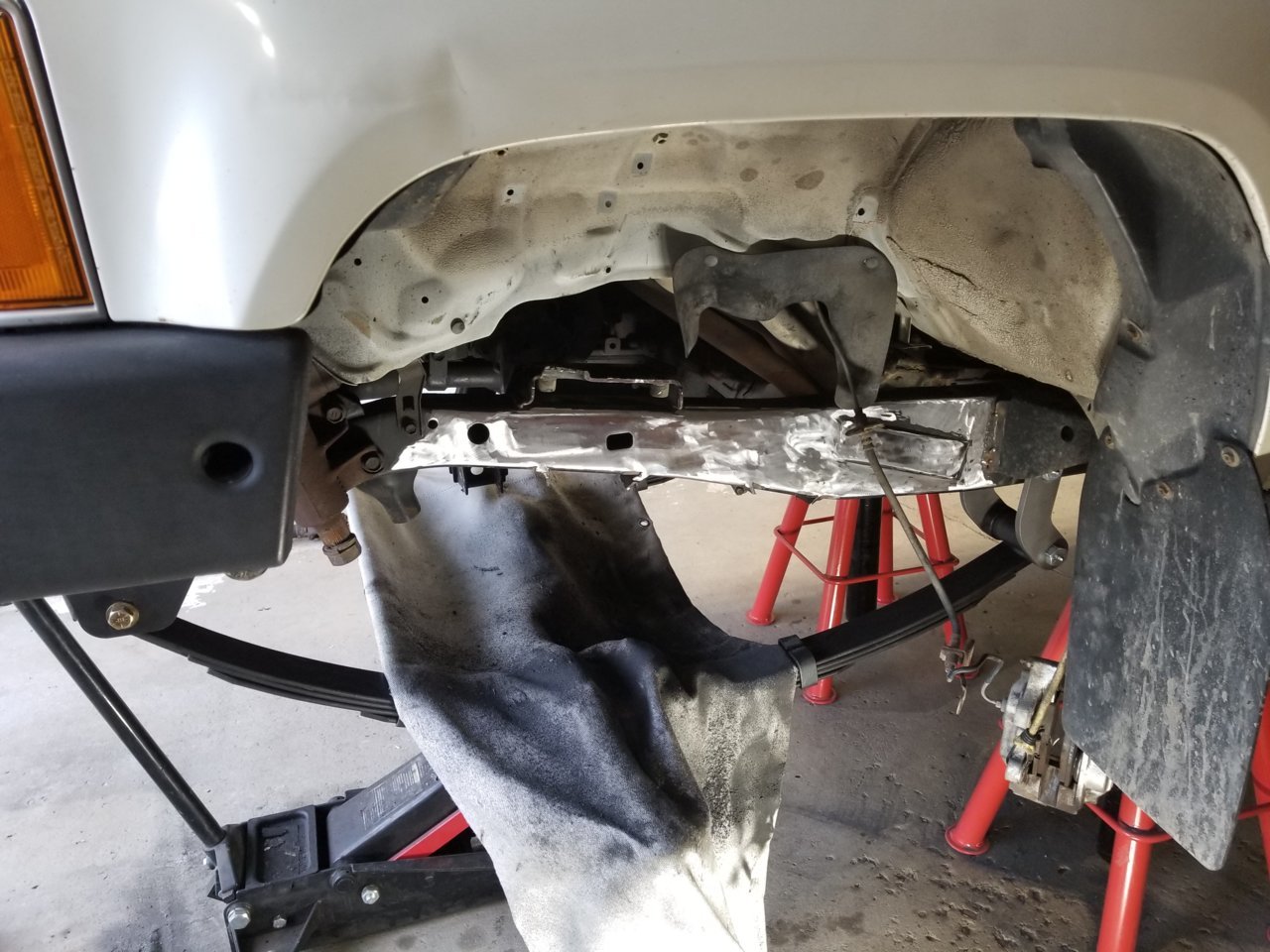

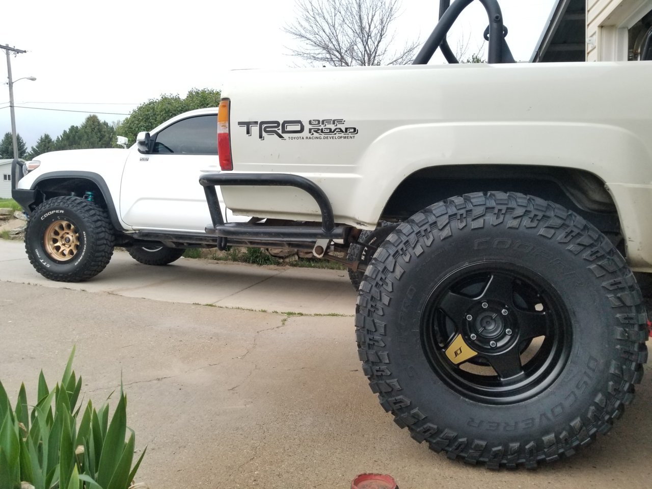

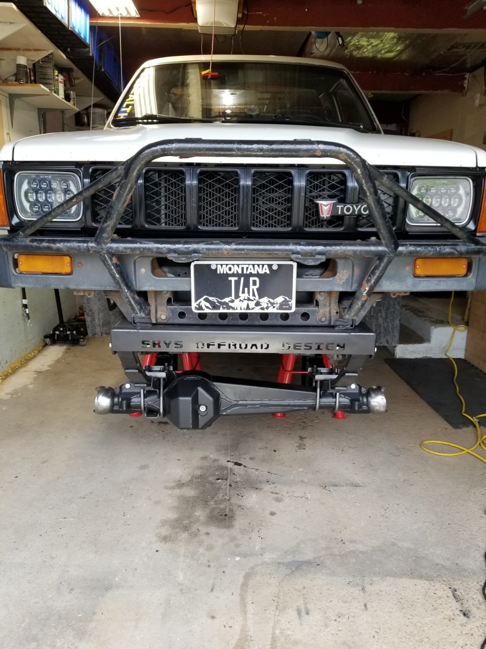

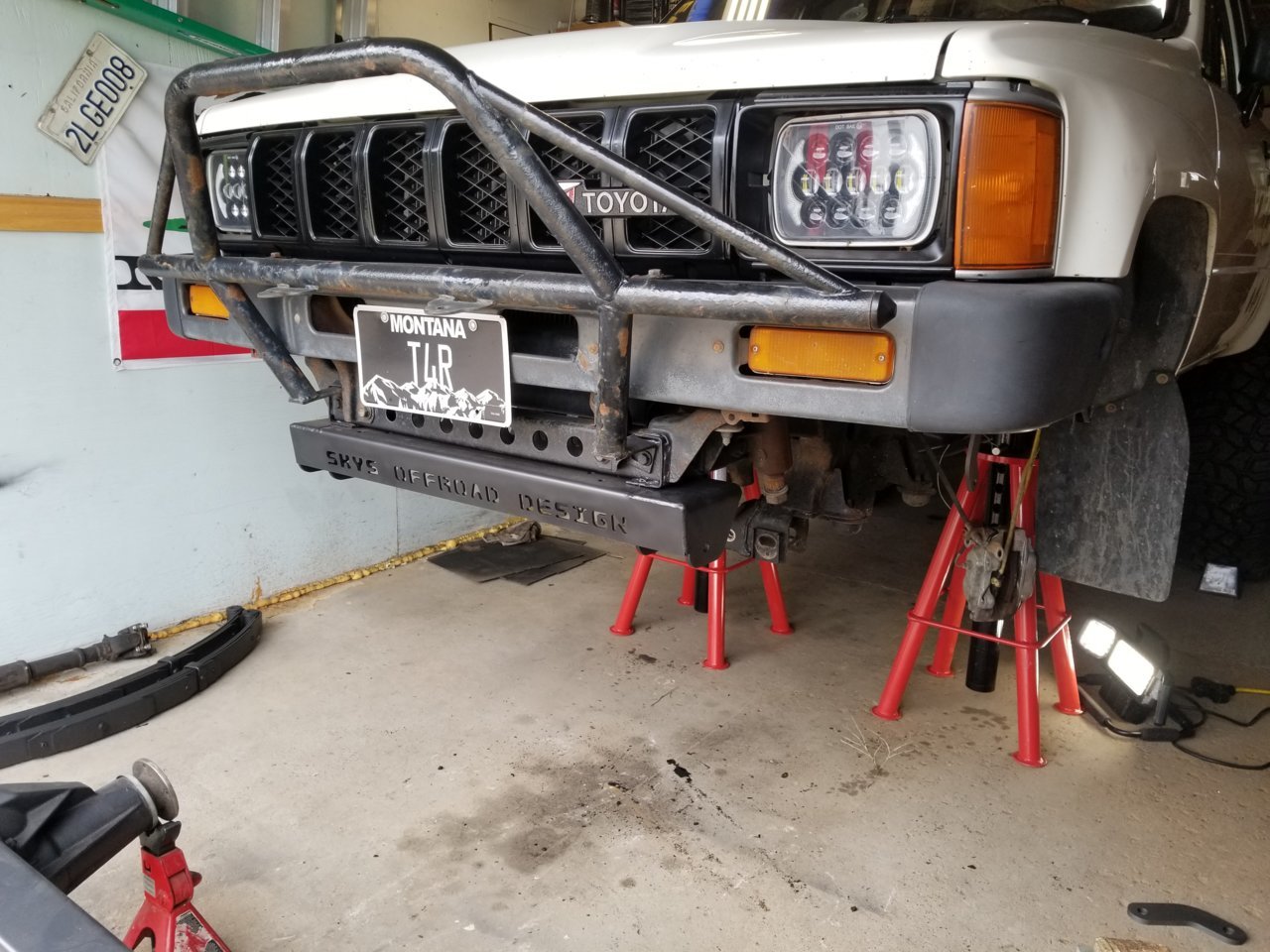

    Front end is coming along. Nothing is welded yet up front. Just mocked for fitment. Also got some gold lugs to match the gold decal.

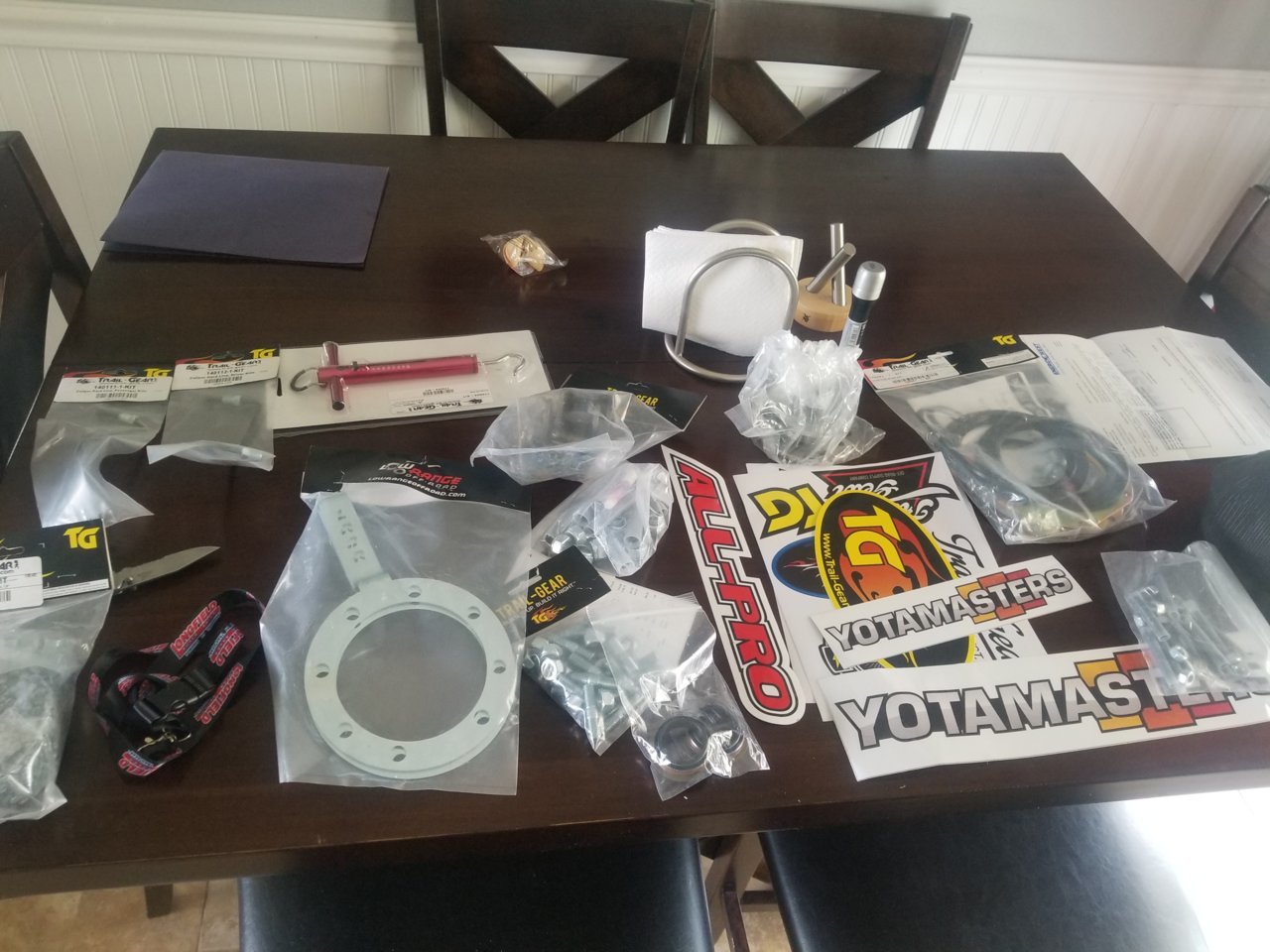

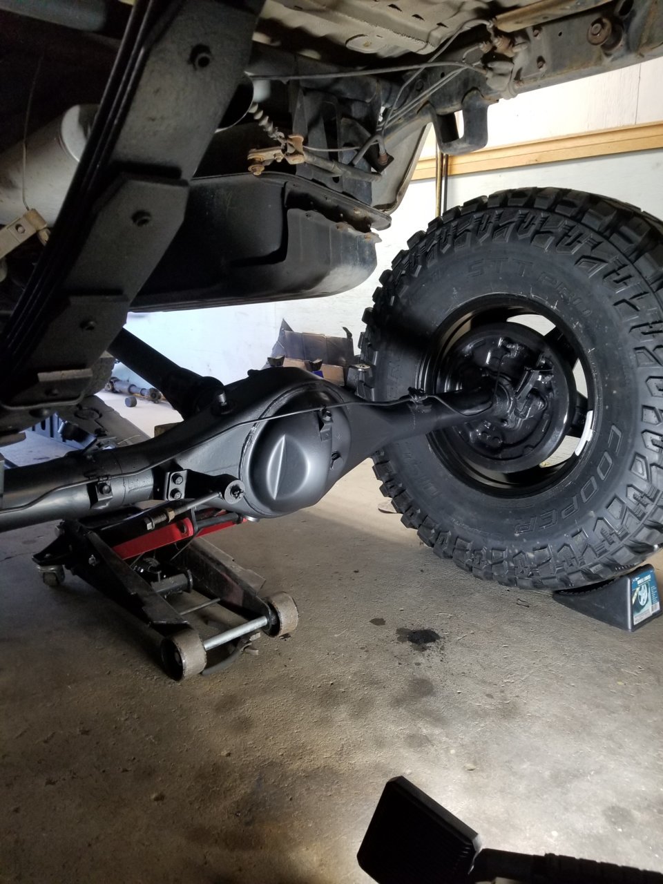

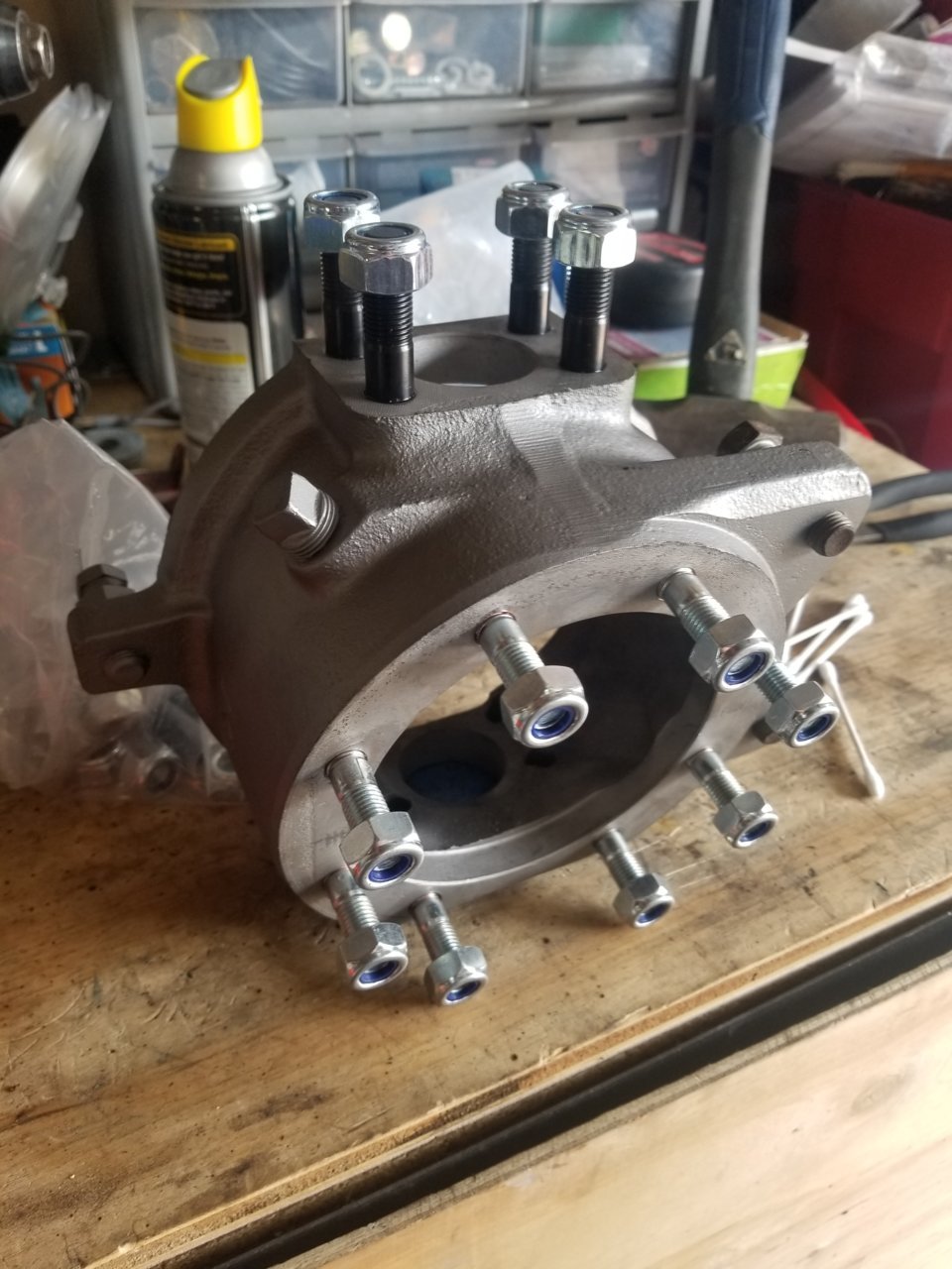

    Need parts!!!! APR studs and all new hardware to make sure the axle is built right

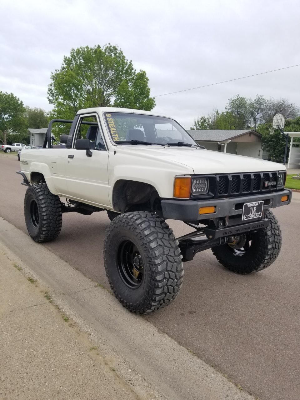

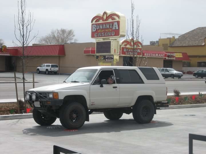

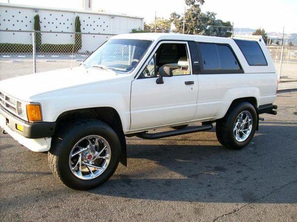

    That's awesome Essentially exactly where my build is going to be someday. 2nd pic was the craigslist ad picture back in 08 when I got her

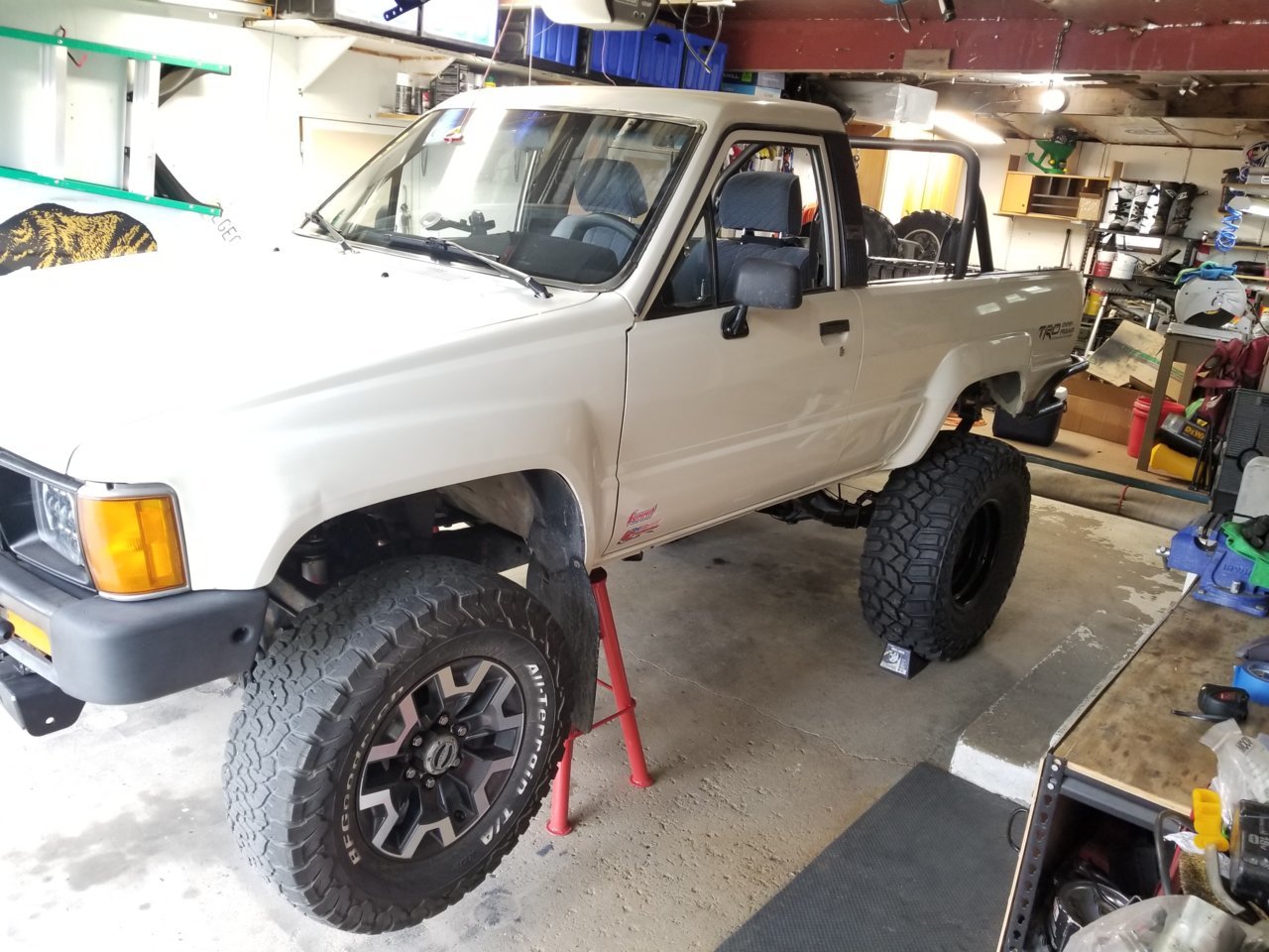

    Thanks brotha, I appreciate it! She needs more but I'm happy shes at least driveable
