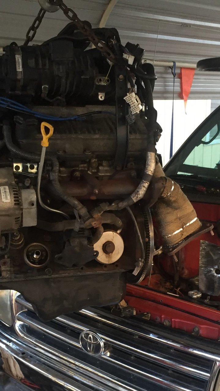

    I usually cut and section the stock 3.4 crossover pipe to move the dump to the driver's side just like the 3.0s.
    The stock throttle cable usually reaches fine.
    You can move the battery to the driver's side and then run the 3.4 intake, or leave batt in stock location and run a shorty intake pipe and a open filter.
    You also need to power the stock 3.0 fuse block and I usually leave them in the stock location and just run a longer cable from the new batt location.
    Also need to swap to 3.0 pan and t100 dipstick and tube.
    You need to spend time on yotatech. They likely have the EDM for your year 3.0 and the donor 3.4 so you can repin the harness correctly.

    I thought i had a pic when i was piecing it together, but this ended up being the best pic i have of the crossover collector.

    Pickeledpigsfeet Yeah I noticed your oil dipstick, did you run it to d plugged hole underneath the engine mount on the side where the oil pan and engine block are connected?I switched the oil pan and the oil suction pipe with the wire mess of the 3.0 to 3.4 nd rotated the oil pan and perfectly fits but obscured the original dipstick so need to relocate the dipstick hole or else you wont get an accurate reading of the oil level.

    None but would like to do an engine swap from 3.0 that got broken at the engine block right by the oil pan passenger side towards the front where the water pump is connected if I am not mistaken.But as I figure out the 96 3.4 engine which I already have it looks like I will have an issue on exhaust and other issue that connects to the air duct nd filter
    I also noticed your modification on the exhaust manifold like the 3.0 coz 3. 4 exhaust manifold mated together on the passenger side.So you cut it and welded it to be on the driver's side like the original 3.0 down to the donut connector nd becomes one piece all d way to the tail pipe..

    Some year blocks just have a plug in the drivers side that you use for the dipstick, other years you have to drill a hole.
    Then to be safe you fill it with oil to the proper amount of oil capacity of the 3.4 and confirm that the dipstick reads correctly. It seems like usually 1/8" over the full mark on the new dipstick is actually full.
    I had the whole 4runner and moved all emissions over to my truck. Including the 3.4 downpipe and cat.
