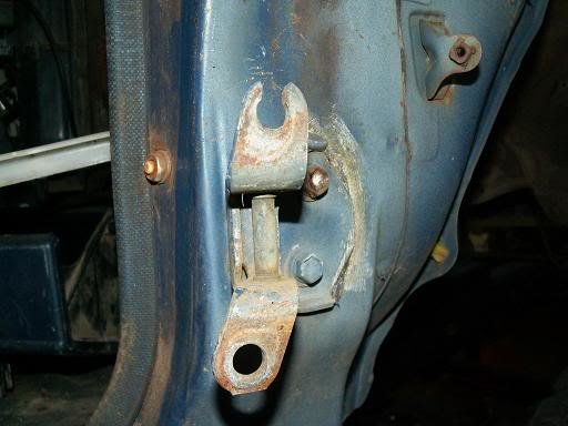

    I will probably do this with my hinges. It really doesn't take long to get them on/off with a ratcheting wrench. Cutting a slot in the top hole of the hinge lets you leave a bolt in loose so you can hang the door instead of struggling to get all the bolts in by yourself.
