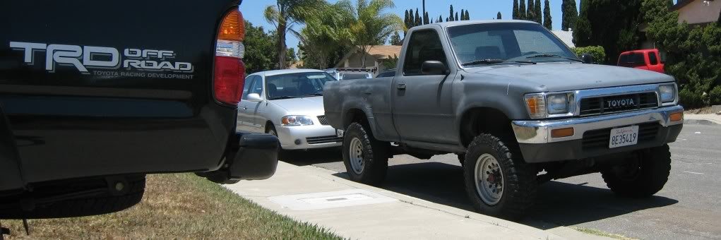

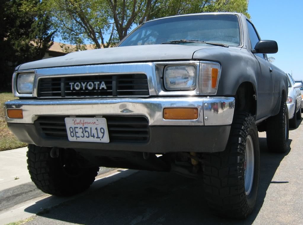

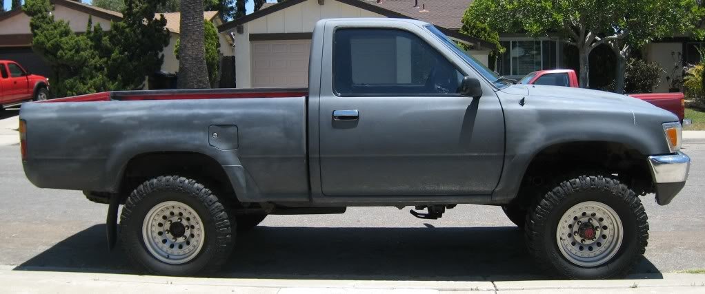

    I had the same truck and it was never like that. 89 single cab 4x4 5 speed 22re.
    Stock suspension on 33's with torsion cracked high but not max.
    the pics show with 31's cause 33 was damn near un drivable as a daily driver around town.

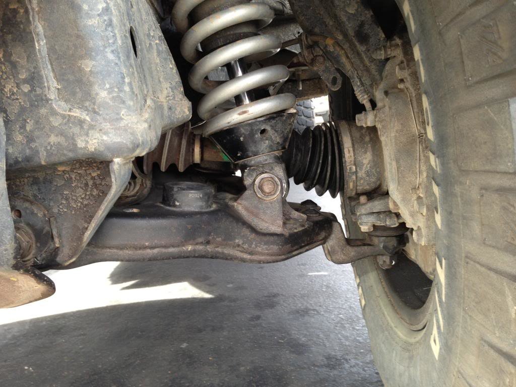

    What would be the cv issue? I havnt checked but I wouldn't be suprised if they're both ruined from the angle. Also dropping the front will help my steering issues because my tie rods are at max angle. What in the CVS could be wrong?
  8. Apr 13, 2015 at 9:00 PM
    Taco me elmo
    Taco me elmo Here, Eat some paint. Drink some Bleach.
    Sep 17, 2010
    #43412
    4,551
    Tophat bobcat
    North of South, East of West
    Slow polished TuRD
    Anti theft 5-Speed
    they could be barely biting the teeth or be blown out from years of abuse.
    Are the fins touching? if so.. they are most likely toast.

    They should not be more angled than this.
  10. Apr 13, 2015 at 9:13 PM
    Lantonben
    Lantonben [OP] Member
    Feb 25, 2015
    #149626
    20
    Ben
    Apex, NC
    White 93 SWB 22re
    3in Suspension 285/75/R16 Hankook Dynapro ATMs Softopper Flowmaster Super 44
    Well then my cv's must be absolutely destroyed then. Like I said. Should be illegal. (Sorry for all the dirt. Still hasn't been cleaned since uwharrie.
