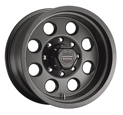

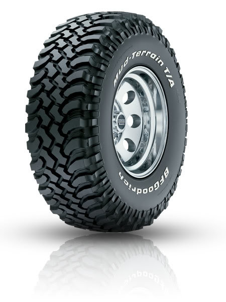

    I drive a basic 95 Tac. 2WD 4 cyl. 2.4 (I Think). I plan to put some new wheels and tires on my truck in order to make it look more like a, well, truck. I want to put at least a 2", but nothing more than a 3" lift on it. I have been searching on the forum, and have found a great bit of information, but nothing specifically relating my truck. The Tacoma Lift FAQ/ Guide is outstanding, but I'm still clueless about what I need for my truck. Here's a picture of my truck, and the tires and wheels I plan to get.
    I read about the ready lift's, but I don't think it'll go on my truck. What all do I need for this lift? I won't be doing any serious off-roading, so this is more for esthetic's. I also need something for my alignment too. The wheels will be 15's, and I'll figure out the tire size. I also assume that fender flares are pretty standard. Any input would be greatly appreciated, and I apologize if this has been discussed before and I just overlooked it.
