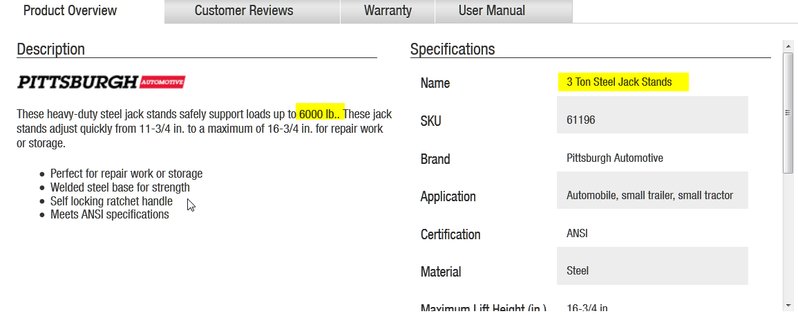

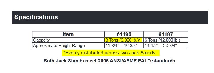

    Jack stand ratings are likely for the pair. So your assumption regarding the HF stands is probably correct.
  12. Jun 22, 2017 at 8:53 AM
    #32
    RysiuM
    RysiuM [OP] Well-Known Member
    Oct 18, 2015
    #167004
    2,709
    Rysiu
    Was Golden State, now Poland EU
    1995 4x4 LX Ext Cab, I4 2.7, MT, 335K miles
    DD Deck+backup camera, LED DRL, All LED except H4 Hella
    Thanks for confirming. I did not know that and I always thought the weight is per jack, not pair. Oh man I was so wrong and so lucky to not overload them. I just read about it, which is probably not a common knowledge (I am a living proof about that :rolleyes:). The same applies to ramps. Here is a picture of the label on my ramps.
    Now I looked at HF site on their all current jack stands and they actually showing that rating. For example:
    The manual actually says exactly what it means:
    So I guess we should follow the statement I saw:
