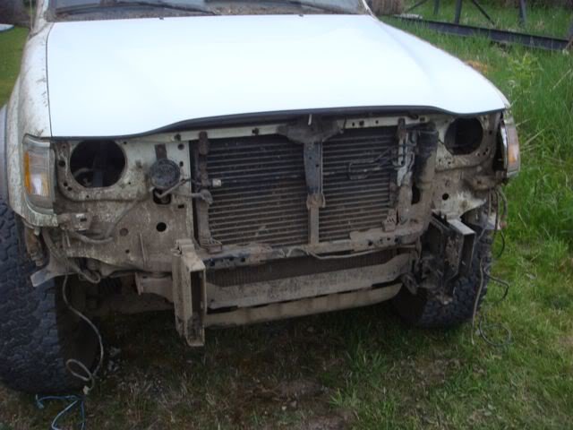

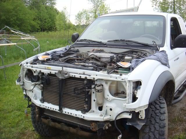

    I say this because swapping an 01-04 front end onto the older trucks is more labour-intensive than the other way around. The holes for the headlights are different.
    Here is the 95.5-97:
    Here is the 01-04:
    Note how the first truck has round holes but the second has oval ones? The 95.5-97 headlights will fit in the oval holes, but the 01-04 headlights will not fit in the round ones without cutting.
    You will also need a whole new hood, which will set you back quite a bit even without adding in the cost of colour-matching it (I was lucky because I found another white truck to buy...but I was fully prepared to paint it if I needed to).
    After that, you still need the corner trim pieces that go under the grille, headlights, and hood latch. You don't actually need corner lights, fenders, or a new bumper (I don't entirely know about the bumper, though, because I installed the ARB with the grille swap too).
