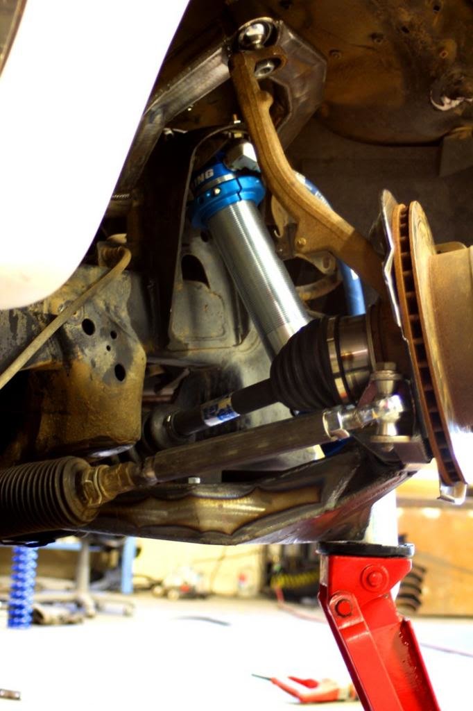

    Is that a standard 8" shock? I have the Camburg specific 8" shocks that collapse to 14 3/8". Could I get a little extra bump travel being 2wd with that shock? Is the current shock extended all the way at droop? There may be a used Camburg kit for sale in the future too

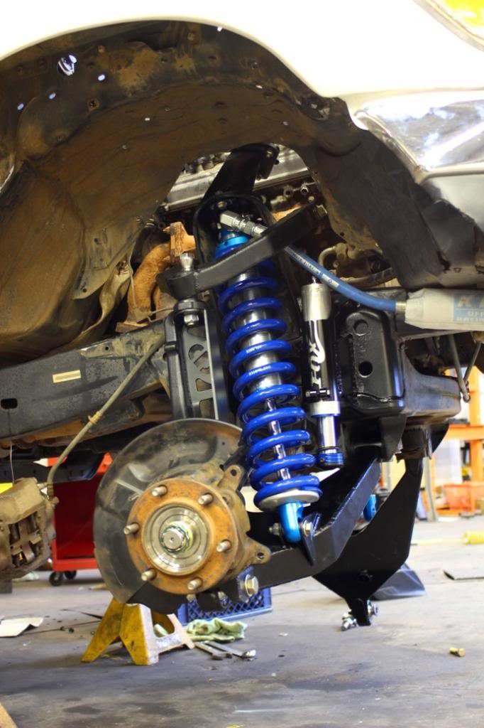

    Soon enough young gwass hoppa lol. MAYBE today if i get everything all finished up. Im honestly surprised no one has made this yet. Its all a tight squeeze, but the geometry worked out almost perfect with only 1/4" of axle plunge.
    The shocks I have now arrived yesterday after a rush order due to KOH and a miscommunication at the start of this build (my fail). With the standard 8" he is loosing a little over 1" of uptravel. Im going to redesign the lower arm a little bit to get that 1" back for the production run. This truck is still at 12.5" travel so itll be alright for a guinea pig truck and he was looking for 12-13" travel. If you or anyone else wants to use their current shortened 8" shocks, then i can just use this current arm and a slightly taller shock mount in the stock coil bucket to locate your shock correctly. The shock mount is EASY for me to change up.
    And you say 2wd?....i have someone currently looking for a junk stock spindle so i can see about making hub blocks. That someone wants this kit and lift spindles. SOOO 4wd and lift spindle will be in the works. They will be bolt on replacement only for this lower arm though because Im going to take full advantage of the lower uniballs and make a race type spindle, not the standard replacement lift spindles.

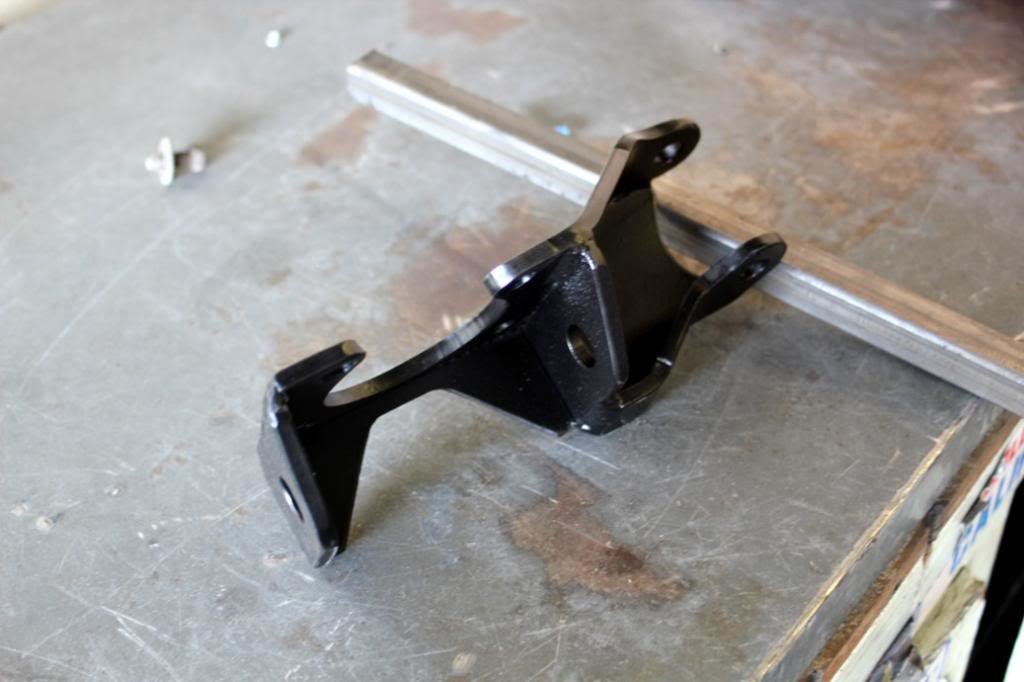

    Well i was HONESTLY going to put up pics of the magic adapter tonight because i just painted everything 30min ago but i totally spaced as I was writing a list of parts for another truck coming back into the shop. The magic is not really that impressive which is why i cant believe no ones done it, though there are obstacles to make it work correctly even with how simple it looks....but a patent pending (hopefully just patent soon) will keep anyone else from trying to make one like it and sell it haha :wink:.
    If any of you know of the black taco i backhalved, that was the list i was writing up. Its coming back for a front and it will be insane!! But all the custom 4wd parts may take a while to get made. Unless bms can ACTUALLY make hubs in less then 9months......theyre claiming 2-3months but Ill believe it when i see it.

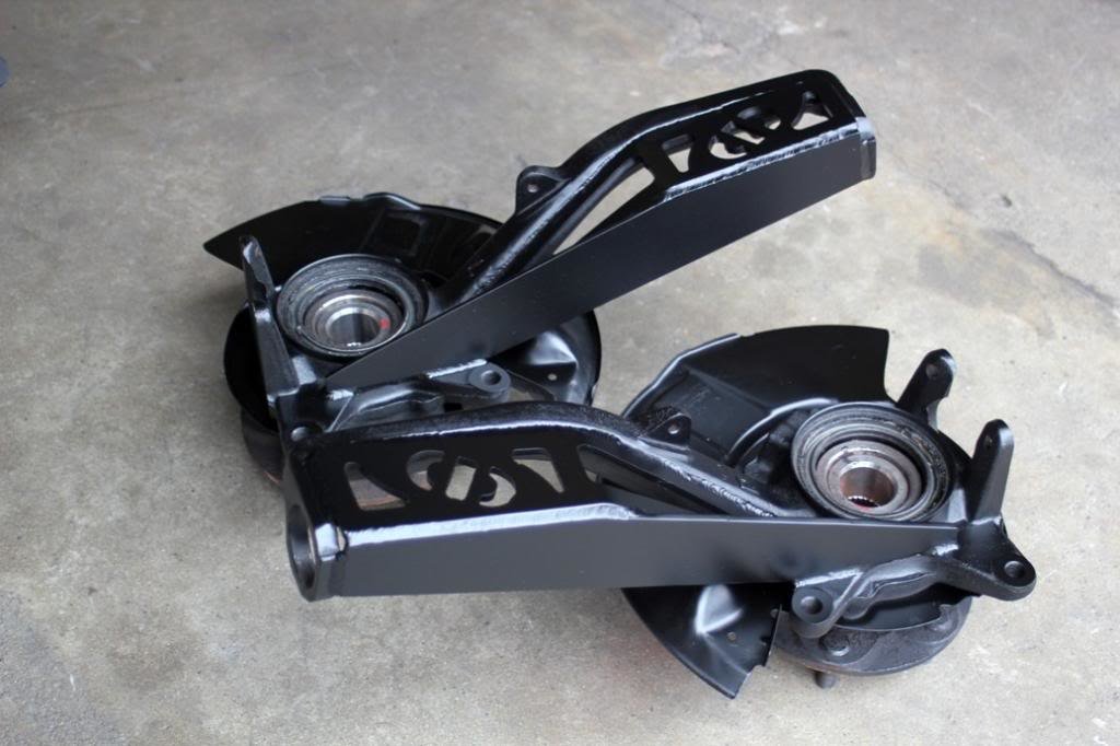

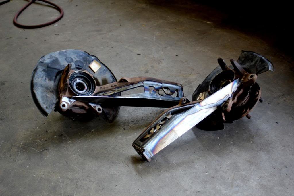

    Well guess what got welded onto his spindles today. The final spindle gussets i have designed are one piece and bent to fit the same as these.

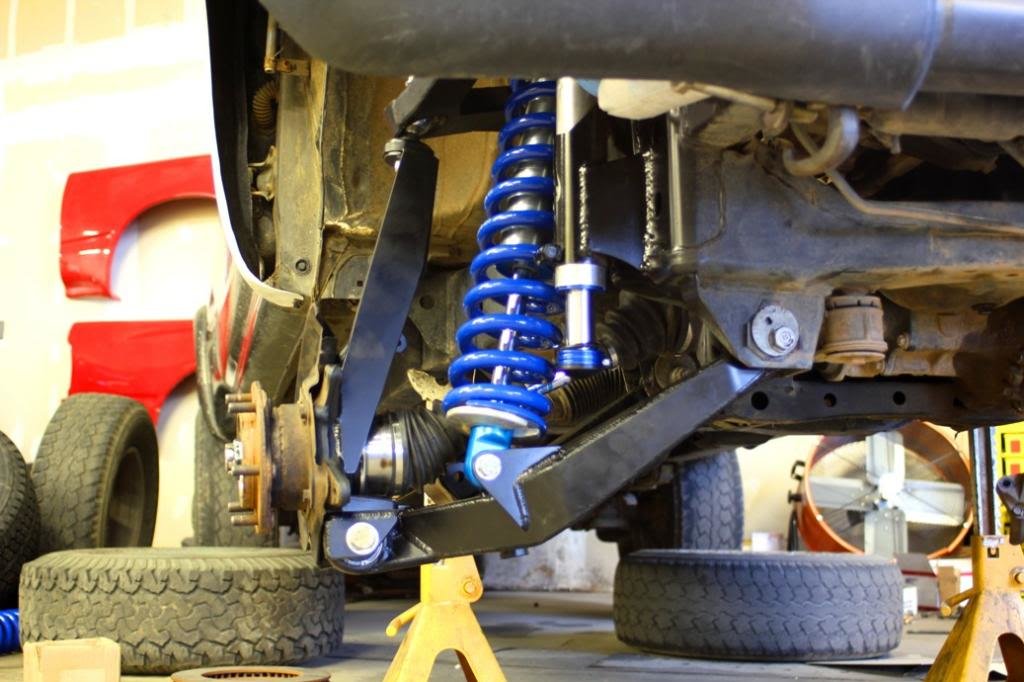

    Alright ive held you out long enough. Not much to it, but double shear lower uniball, double shear steering with no bumpsteer....everything you need. I dont have pricing together yet, but im getting my machinist to get me some cost numbers so i can get a real price list together for everyone

    That looks great! Do you really have trust in that lower portion of the spindle that the piece attaches to? Or Will the spindle be gusseted?

    I trust it. Ive never seen it fail before. Ive seen the ends of others LT lower control arms rip off without any damage to the 4 lower bolt area, so it seems pretty stout

    Another pic of the spindle gussets all welded up and painted

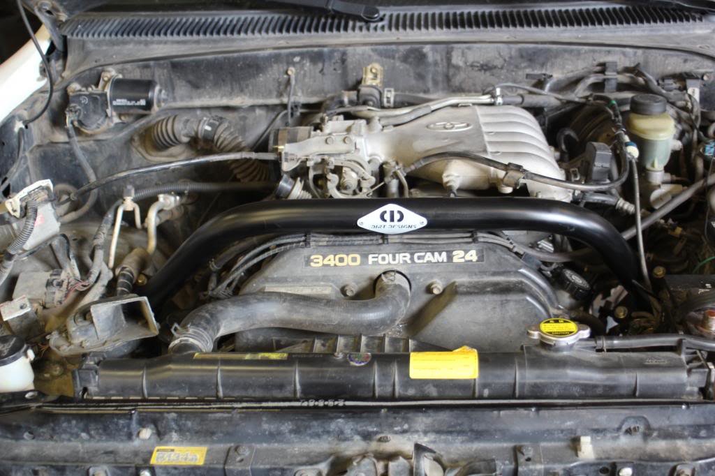

    And how about a 3 piece bolt on engine cage? Boxed structures on the shock buckets to keep them from blowing out the tops. And a removable tube (1.75x0.120 DOM) to brace the two together. Sorry not for the supercharger. But we do have jigs made so these should be for sale soon.
    And some more pics of the kit. Its getting close. Brakelines should be here soon, and then itll be ready for a test drive.

    Does the brake caliper hit the shock while turning?

    Of course!! Full droop and full steering the banjo bolt head has 3/4" clearance on a 600lb spring.
