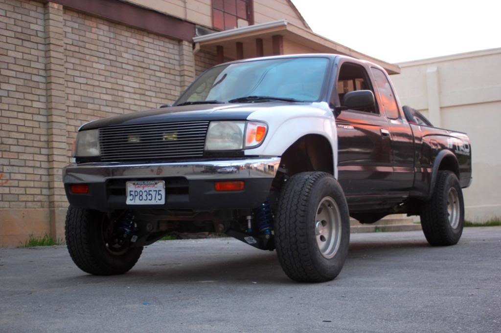

    Truck went out before i left for BAP, but i didnt have time to upload pics......so here ya go
    Hopefully he'll get some larger tires soon

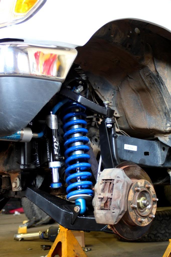

    Steve, you say the D-Max is getting a new front end, just curious what's wrong with the current setup or will you be switching it to beams too?

    One issue is no one wants to make a heavy enough spring. He doesnt want to loose much travel by changing the motion ratio.....sooooo why not go TT on it? hahah Yep..

    I tried contacting a mod about posting prices, so not sure if its cool
    If i can get an order of 5 people i can do a small run of kits at $3k ea.
    Included in the kit:
    -boxed upper arms with 1"uni and delrin bushings
    -boxed lower arms with 1"uni and rubber bushings
    *lower delrin is an option, but takes special alignment conditions
    -uniball adapter for the stock uprights
    *Includes double shear steering tabs with corrected steering
    -outer heim steering (tierods+heims)
    *This will be threaded into the stock inner tierod
    -extended stainless brakelines
    -limit straps + upper weld on frame tab
    -upper shock mount
    -grade 8 bolts
    SOOOOO whos interested?

    how about just uca's with uniball?

    Couldn't run it without the LCA too. They stick out wider then stock ones

    Actually, i have replacement ucas designed for this truck. Same look, upper arm uniball, delrin bushings.......
