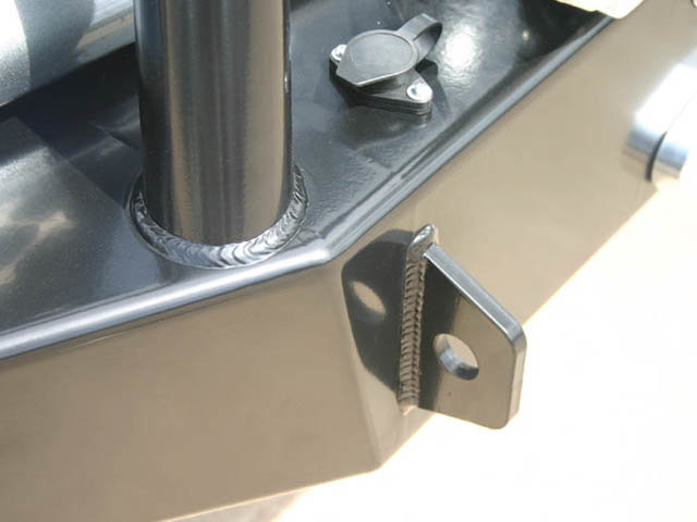

    Anyone own a shrockworks bumper? I was just wondering how they pull this off?(the plug for the controller) I cant afford this high end bumper... :)
  3. Nov 29, 2010 at 1:55 PM
    #443
    phidauex
    phidauex Well-Known Member
    Jul 24, 2009
    #20114
    104
    Sam
    Boulder, CO
    '96 4x4 V6, manual, 201k
    Small lift and a topper!
    That wouldn't be an issue at all, an easy DIY project.
    The controller plug on your winch control box is just riveted on, you would drill out the rivets, and cut the 3 or 4 wires that connect the plug to the interior of the controller (probably a green, a black and a white wire).
    Make some extensions to that cable with butt splices and automotive wire, and run the plug to the new location. Drill a hole with a hole saw, and rivet or screw the plug coupler to the new location!

    Ok sounds good. Still waiting on funds to get a bumper coming. Still gotta find a place to mount control box though right? Ideally I'd like mine under hood if the plug was easily accessible like the picture shown.

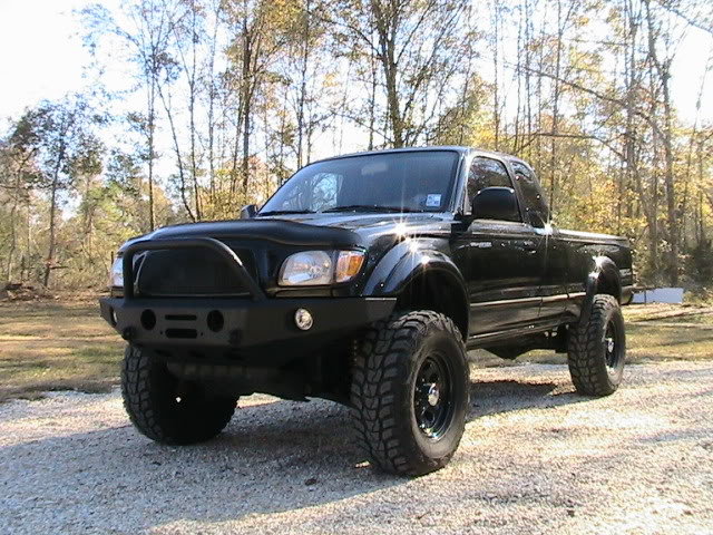

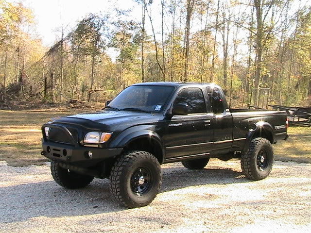

  20. Dec 19, 2010 at 9:08 AM
    #460
    Southern01Taco
    Southern01Taco Well-Known Member
    Jul 20, 2010
    #40457
    1,957
    Sean
    Holden, La
    01 V6 4x4 Xtra Cab SR5
    Here are some pics as promised. I had one minor problem when installing the foglights. I had to trim about a 1/2" inch off of the bottom of the adjustable bracket to get the foglight to go lower. It was no big deal, I just thought I would let yall know.
