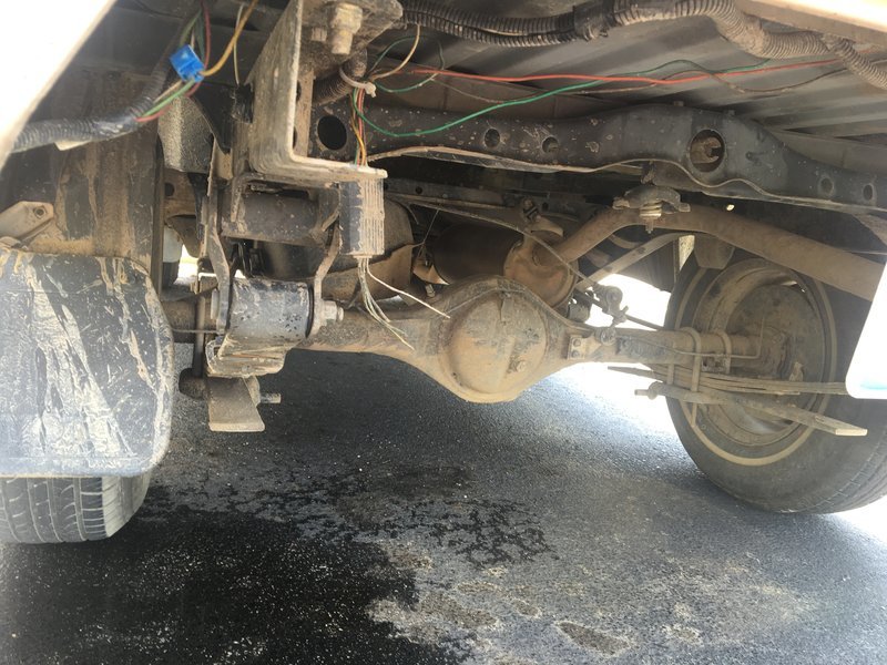

    I am not familiar with 5 luggers, can you take a picture of the rear mounts, if I know what they are like I can likely recommend something

    Its eyelets on top and bottom. Only pic I have atm

    Okay and are the bars that the eyelets go on about 3/4" diameter?

    @Speedytech7 Alright yep 3/4" eyelets and its 19" from center to center as it sits in parking lot

    Okay so presumably you could use 4wd Tacoma shocks if you measure. They are super cheap for OE replacements on RockAuto.

    It seems stock 4wd ones wont work. They have an extended length of 20" which only gives me 1 inch of down travel
