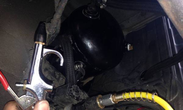

    I know it's not turbo related but I thought I'd show off my new train horn and air compressor setup. It's all super compact right behind the cab under the bed. I have a pressure relief valve, a gallon air tank and a chuck to hook up any air tool or tire fill valve
    The compressor is under the back seat in the storage compartment.
    I put a few coats of rubberized undercoating to waterproof the valves and stuff.
