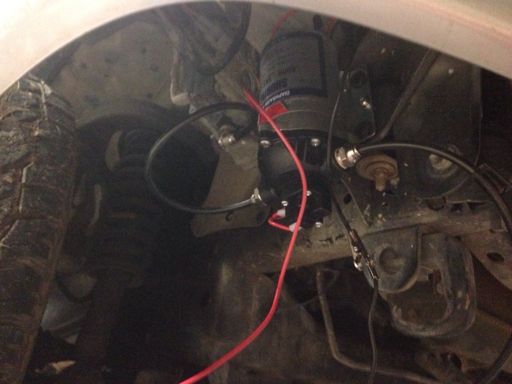

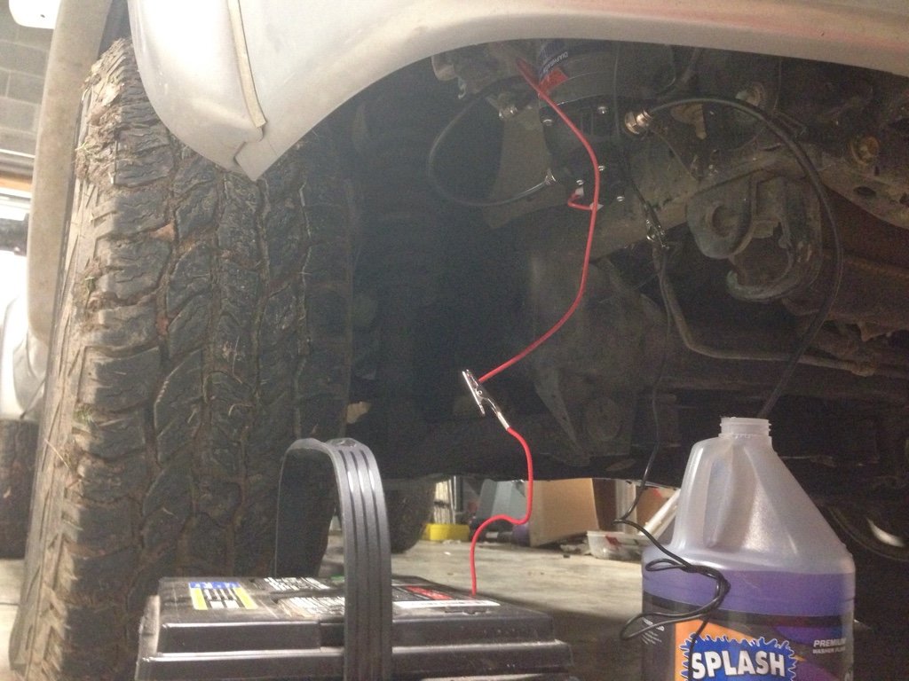

    I guess I could start a build thread here. I'll just post everything twice, lol.
    For tuning I'm not going to do anything real fancy. I did start on my DIY water/methanol injection system last weekend. I got the pump mounted, but that was as far as I got. My wife left her inside lights on and killed her car battery, so she took my 4Runner the rest of the weekend. Couldn't find the jumper cables, so had to throw her battery on the charger.

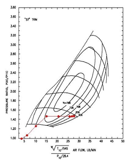

    Not really sure where I want to put the nozzle. I've been contemplating either after the MAF, or pre-turbo, because pre-turbo helps with the turbo's efficiency, and looking at the compressor map, I suspect it'll be a bit inefficient at the higher RPMs.

    I don't think compressor maps and turbo efficiency need to be worried about with a stock toyota engine at low boost. Your MAF won't appreciate pre turbo meth injection and your ride won't run right. I would be more worried about intercooling than turbo efficiency.

    Being in an inefficient spot on the compressor map means higher air intake temps. I don't think the water/methanol mix will effect the MAF. After it's gone through the turbo it'll be vaporized. At least, that's what I've read. I guess I'll find out, lol. FedEx says my manifolds are getting here this Friday, I'm pretty stoked.
