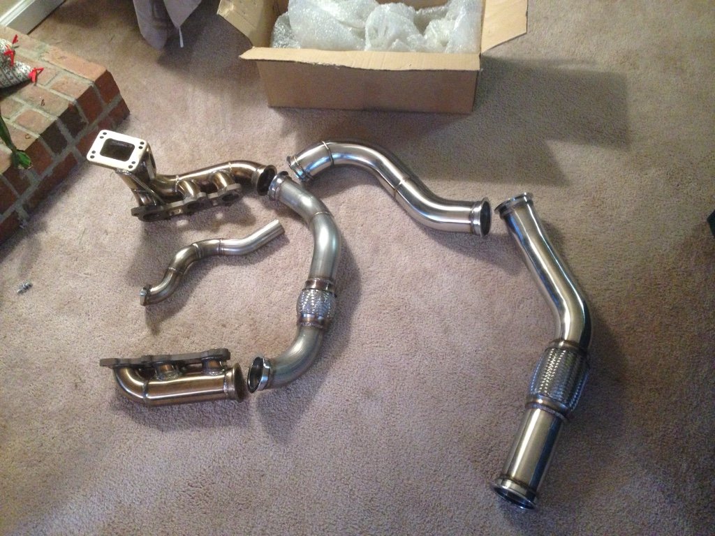

    Hey man, doing my install in two weeks. Going to get the Toyota exhaust manifold gaskets and have some Cu based high temp FIPG for the turbo, what else do I need for this install that's not included in the kit (going to forgo the watercooling for now)?
    Any hints, tips, tricks, etc... would be appreciated.

    The only thing I would highly reccomend for now is switching out all the V-band and t-bolt clamps for quality SS clamps with a grade 8 yellow zinc bolt and nut. Ive stripped 4 already. Also recommend getting a high quality wastegate exhaust gasket instead of the swiss cheese looking metal one with asbestos type material samwiched in between that comes with the kit. The exhaust already ate a little hole out of mine on the top so my o2 readings are still a little wack. And whatever you do, USE LOCTITE on all the exhaust v-band clamps. I find myself having to tighten them up every few months.

    Stainless steel. I bought a couple 2.5" metal vband gaskets from ebay and caked the copper gasket maker on both sides before installing and those haven't leaked at all. It's the post turbo 3" vbands and the wastegate gaskets that sucked for me. And the grade 8 clamps I bought don't show any signs of stripping while the supplied ones did right away :notsure:
    One major design flaw with the headers and downpipe is that the flanges they use are all female. One flange end is supposed to have a permanent ring that fits into the other side to make a tight fit. These ones need to be perfectly aligned when clamping them together.

    It shouldnt :notsure: Heard that it should hold up very well to the heat. Its rated over 700F. The interior gasket might burn up but toward the edges, especially with this style header, the temps should be manageable.
    Ahh, gotcha. Yeah, the pipe design confused me. I'm going to try to assemble them out of the truck as much as possible before installing.
