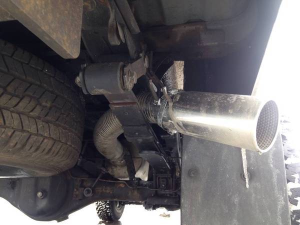

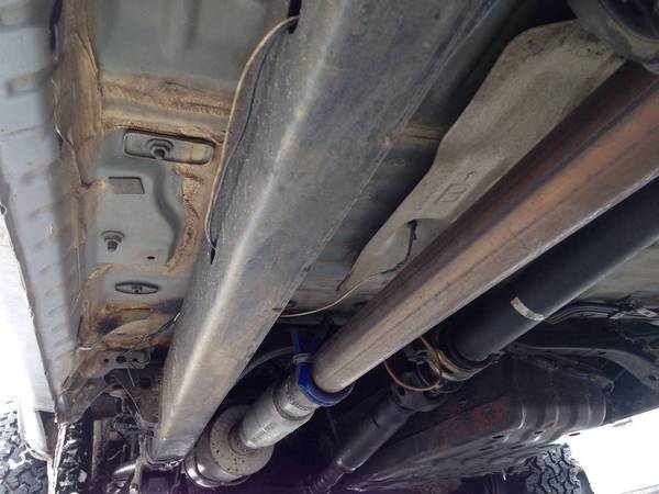

    Well I made some changes to my truck. I completely finished my exhaust and put another muffler (summit racing 18" glasspack) inline to quiet it down a bit more. I also bought some remanufactured injectors and put those in there while at the same time putting my stock MAF back in instead of the supra one I was using with the 320cc ford injectors. To my surprise my truck runs great and WOT AFRs are 11-12 consistently with absolutely no tuning at all. I might get a boost controler and see how much boost these stock injectors can handle. I read somewhere around 240-260WHP and that's cool with me until I'm in the mood to hook up this AIC properly.
