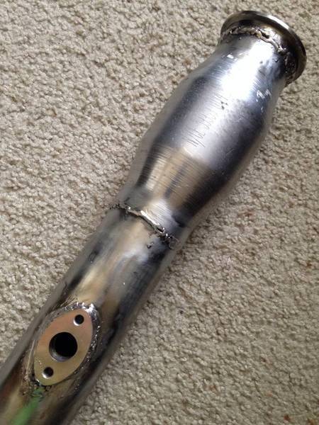

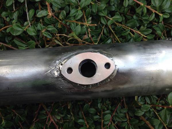

    Do I need to weld in a bung after the cat too? I thought I could just put them in the bungs that are in the cx downpipe.

    The CX kit comes with one wideband sensor bung and one stock 2-bolt O2 sensor bung. You will need to either weld in a second bung for the post cat sensor or get an O2 simulator.

    Good to know. Will pick up an ss bung asap......where did you get that bung from, having a hard time finding that oval shaped mount.
    Edit: found one. It's just steel, but should weld up ok to the ss.
