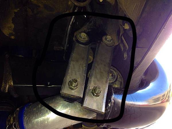

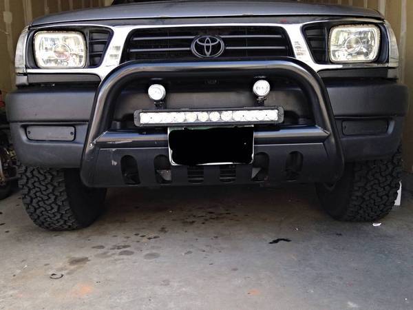

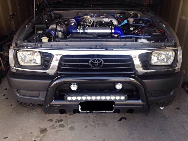

    I installed a bull/push bar on my 96 yesterday from a 2006 Tacoma. If anyone is interested on the bracket specs to make a bull bar from a 2006 Tacoma fit your 95.5-96 (not 100% sure about 97s, but it definitely won't fit 98+) Tacoma, you will need four 1/4" thick plates that are at least 1.5" wide. Two of the plates (the rear ones) must have a hole-to-hole space of 123mm and the other two (the ones closest to the front of the truck) will have a hole-to-hole space of 145mm.
    The upper brackets will go in between the bumper and frame mounting surfaces (it will be tight) and the bull bar will mount to the inside of the brackets. This pic is from the passenger side looking inward.

  13. Apr 19, 2015 at 5:53 PM
    #333
    Robb235
    Robb235 Well-Known Member
    Sep 8, 2013
    #112091
    233
    Chattanooga, TN
    1999 Turbo 4Runner
    Turbo 5vz uaEFI Standalone ECU 231mm Tundra Brakes RR Diff Lock Hayden 699 Transmission Cooler
    Looks good man, I like it.
