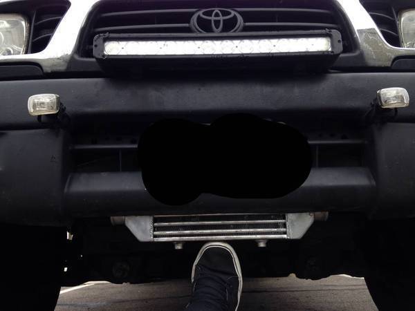

    Yeah it sucks not being able to buy everything at once comfortably. Have you measured out exactly where you can put the intercooler? I'm guessing your ride has the same non-existent room as mine being a 96 and all. If you decide to mount yours like mine, I can send you the exact measurements and you can just cut the pipes to length. It would save a lot of time.
    Actually come to think of it I took my radiator skid plate off to mount the IC and I doubt you'd want to do that. I plan on getting an ebay bull/push bar to protect everything down there without having to restrict the air coming in contact with the IC.

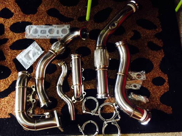

    My headers came in today and boy are they purtty...

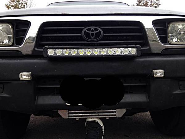

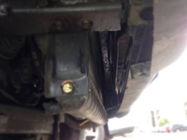

    I took my bumper off to install my PS cooler and noticed that I can bolt the front radiator guard on upside down. This makes a nice little pocket for my intercooler to fit in

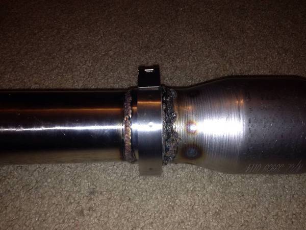

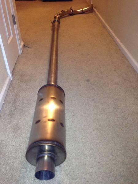

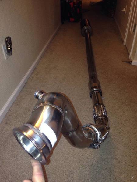

    I got my exhaust mapped out. Just welded a V-band flange to the high-flow cat so I can clamp the exhaust straight to the downpipe (the muffler and straight pipe aren't welded, I just stuck it together for the picture).

    I bet you guys can't tell which weld bead is from CX and which one I did LOL.
    It was already pretty dark when I started. I'll probably go over it tomorrow.
    I'll weld the second o2 sensor bung in the straight pipe probably tomorrow.

    Not too bad for a Harbor Freight arc welder... a tig is much easier to do exhaust with.
    Everything but the muffler is welded because I have to wait until the headers and downpipe are hooked up to get an idea of exactly where to put it.

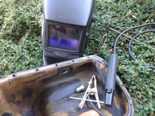

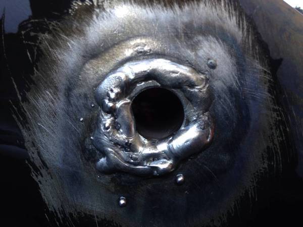

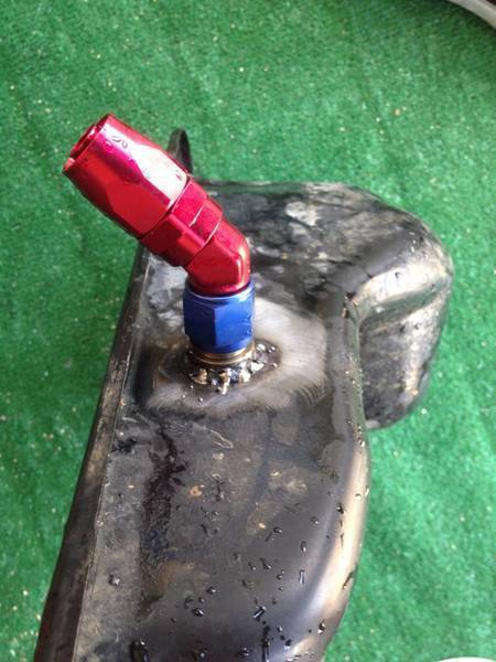

    So I was really thinking... Do I pay $100 for a shop to weld my oil return bung in or do I attempt to do it myself. Ah what the heck.
    NO LEAKS!!!!! Took me literally 7 minutes to weld it and it turned out great! $100 saved!

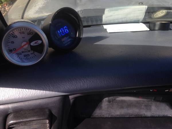

    Hooked up the glowshift wideband AFR gauge last night. The sensor isn't screwed in though.
