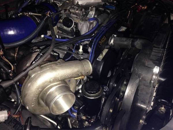

    Runs great and no leaks so far. I still have to weld the muffler on and cut down/install the charge pipes.

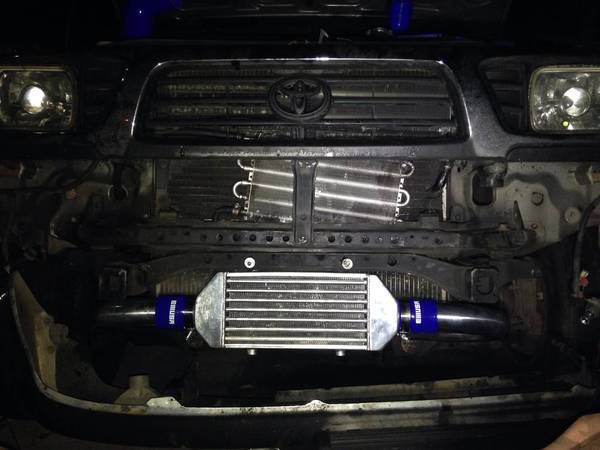

    Intercooler is mounted...
    And don't judge be for my crooked power steering cooler :D
