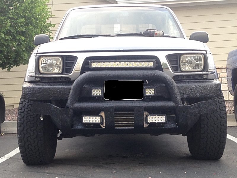

    image.jpg I welded up a new bumper. Believe it or not I'm not done with the lights :)

    Did you change color on your truck?

    Na, still grey. I did Herculine a few things though
