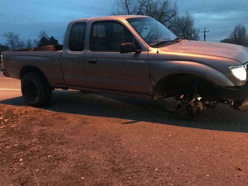

    If you have any doubts in the integrity of your ball joints, change them. Usually it's the lower joint that fails on these tacos (AND I DID CHANGE THIS LOWER BALL JOINT), but it was the upper that popped out which pulled my no-more-than-a-year-old lower joint right out. Learn from me dudes. 10 minutes prior I was goin 75mph on the highway. Thank God.IMG_0134.jpg

    Dude.... So what ur sayin is dont slow down and we should be fine hahaha. Glad ur alright

    Does insurance cover this?

    Na just the tow.
    2 cv axles, 4 ball joints and a tie rod or two is probably less than my deductible:notsure:

    Not with labor.

    Perfect time for LT.....hahah. jk.
    Glad you're OK man.....!!! That could've been real bad.

    This is what I was hinting at. If your insurance will cover it you'll have a sizable chunk out of that front LT bill. I took my truck in for alignment after I installed 5100's and they told me it needed tie rods and the cost + installation was $900.

    That's freaking nuts. Tie rods are like $100 for both (partsgeek) and take an hour to replace (for me anyway). I'll probably replace my steering rack too... as it's leaking.
    I guess I'll see what the insurance would cover. If they only agree to pay for my passenger ball joints to get replaced then I'd be better off doing the work myself.

    Yeah that's my point. The quote they'll give you will be off the charts so it'll definitely be worth it to pay your deductible and get a fat check and do w/e you want with it.

    So I took yall's advice and filed an insurance claim... it's getting repaired at the dealership .
    I'm hoping they aren't gonna charge me my $500 deductible to replace $200 worth of parts. Hopefully Toyota does what they do best and demand that the muffler bearings and headlight fluid be replaced.... bill ain't on me

    They are paying the dealership directly. So far they said that only the ball joints, cv and brake lines are all that are getting replaced... which sucks because that's $300 worth of parts that would have taken me 2 hours to replace myself. My steering rack was leaking a heck of a lot more than usual after that accident, so hopefully they see and consider that. :facepalm:
