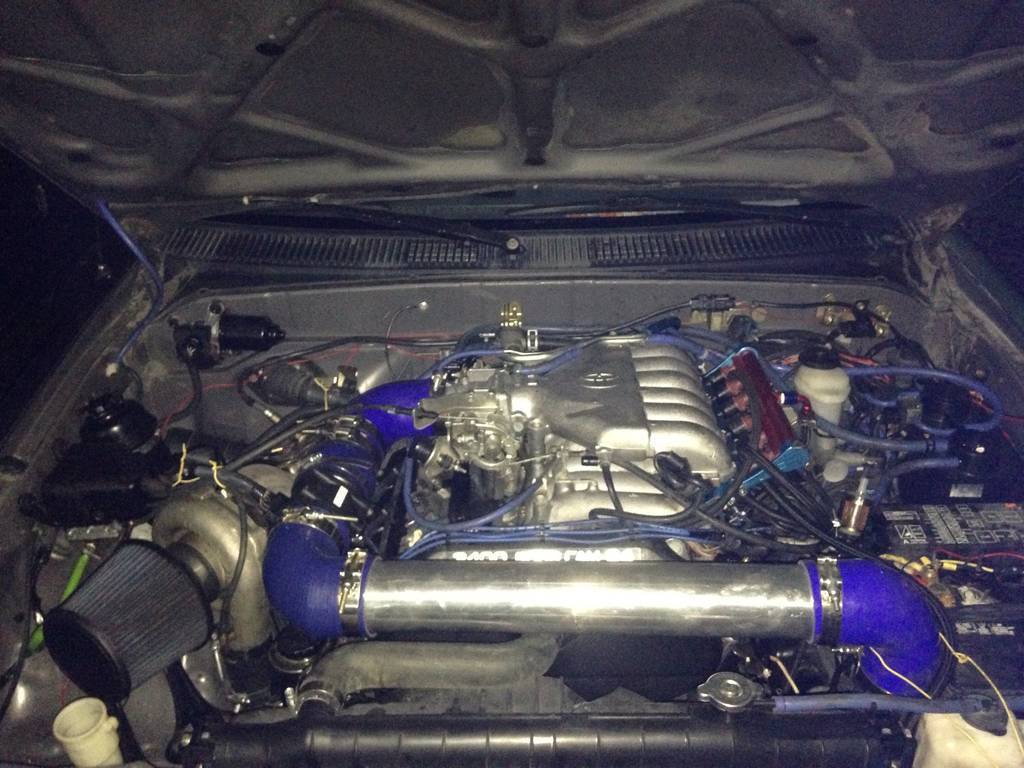

    Im not done with the charge pipes by any means but I hooked them up with what I had and the lengths of the pipe were already correct enough to hook up and get boost for now. I'm not going to keep the MAF right behind a bend and I'd rather use 2.5 pipe for the top horizontal piece than that 3" but my truck totally stalled using 2.5 and the 90 degree elbow right before the MAF. It idled OK with this 3". I drove it around for a while testing it out and tried a 0-60 pull. Probably literally 500lbs of extra weight or more in the camper shell + all my junk and my back tires wouldn't get a grip until 2nd gear. A solid 8 seconds.
    I'll bet any money with no extra weight and in 4wd it would do it in 6.5-7 seconds easy with the stock tune and 5 psi (that's all I'm getting still). The spool is amazing and the lag is almost non-existent. Very impressed to say the least. AFR is at 15 full boost full throttle... not going to be stupid with it but it's not so lean that engine damage is inevitable.
    I've decided that I'm going to stay at 6-8 psi (im still getting an FIC to battle leaning out under boost). I know a lot of other people get greedy and want more and more but honestly this is amazing enough for my standards. I assume 300 WHP is where I'm going be at and stay at when all is said and done.

    Umm, yes it is... 15 is very bad. I would keep out of boost until you get AFR's down into the 11's at full boost/throttle... :notsure:

    Na it's not so bad. 5vz's see leaning like that for 200k miles all the time with the S/C and no fuel mods. It's not healthy by any means but with a bottle of octane booster and a splash of 110 race gas every tank I'll be ok until I get the AIC light(ish) on the pedal. After all I'm running the same boost pressure as I have been for the last year with the rear mount setup that wasn't intercooled.

    Gio, could you do me a huge favor? I'm planning out my intake since I'm building it myself instead of going with the kit (not using an intercooler). Could you take some "birds eye" pictures under the good? Basically with the camera directly above the turbo so that I can see exactly where the turbo is in relation to the throttle body. Big thanks in advance.
